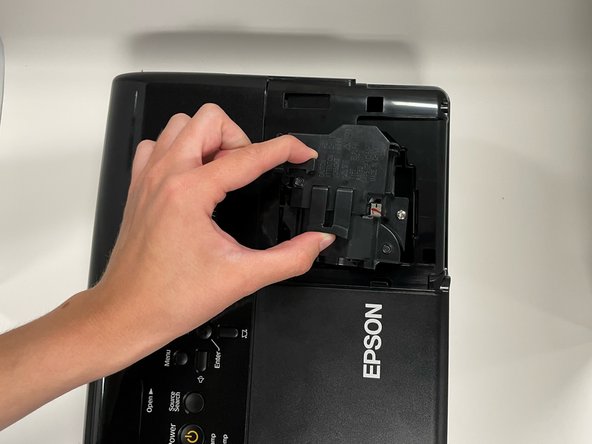

      • Use a Phillips #0 screwdriver to remove the one 5.0 mm screw from the lamp cover on the back of the device.
    2. Epson PowerLite 77c Lamp Replacement: crwdns2935265:02crwdnd2935265:01crwdnd2935265:01crwdne2935265:0
      • Slide the cover toward you, then lift it to remove it.
    3. Epson PowerLite 77c Lamp Replacement: crwdns2935265:03crwdnd2935265:01crwdnd2935265:02crwdne2935265:0 Epson PowerLite 77c Lamp Replacement: crwdns2935265:03crwdnd2935265:02crwdnd2935265:02crwdne2935265:0
      • Loosen the two 5.0 mm captive screws with a Phillips #0 screwdriver.
      • Captive screws cannot be fully removed. Simply loosen the captive screws until the lamp housing releases, but do not attempt to remove them.
      • Pinch the two release triggers to unlatch the lamp housing, and lift upward to remove it.
