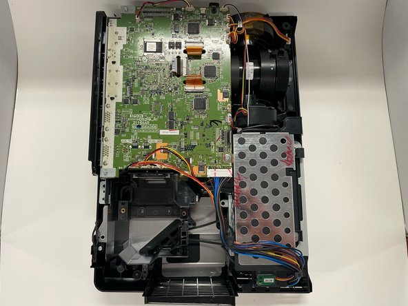

    1. Epson PowerLite 77c Fan Replacement, Fan: crwdns2935265:04crwdnd2935265:01crwdnd2935265:01crwdne2935265:0
      • Use a Phillips #0 screwdriver to remove the seven 5.0 mm screws on the base panel.
      • Pick up the projector with both hands, sandwiching the top and bottom of the projector together, and place it right-side-up, with the ports facing you.
      • Lift the top panel up.
      • Two connectors are holding the top panel to the motherboard; be careful not to damage them as you lift the top panel.
    2. Epson PowerLite 77c Fan Replacement: crwdns2935265:05crwdnd2935265:01crwdnd2935265:02crwdne2935265:0 Epson PowerLite 77c Fan Replacement: crwdns2935265:05crwdnd2935265:02crwdnd2935265:02crwdne2935265:0
      • Flip the locking bar of the ZIF connector vertically, then delicately remove the ribbon cable.
      • Grip the cable connector as close as possible to the plug, then pull it straight up until it releases from the motherboard.
      • Remove the top panel.

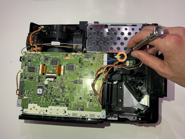

    3. Epson PowerLite 77c Fan Replacement: crwdns2935265:06crwdnd2935265:01crwdnd2935265:01crwdne2935265:0
      • Use a Phillips #0 screwdriver to remove the two 5.0 mm screws.
    4. Epson PowerLite 77c Fan Replacement: crwdns2935265:07crwdnd2935265:01crwdnd2935265:02crwdne2935265:0 Epson PowerLite 77c Fan Replacement: crwdns2935265:07crwdnd2935265:02crwdnd2935265:02crwdne2935265:0
      • Remove the one 5.0 mm screw on the right side of the gap with a Phillips #0 screwdriver.
      • Remove the one 5.0 mm screw on the left side of the gap with a Phillips #0 screwdriver.

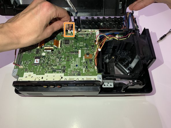

    5. Epson PowerLite 77c Fan Replacement: crwdns2935265:08crwdnd2935265:01crwdnd2935265:01crwdne2935265:0
      • On the right side of the motherboard, grip the plug labeled "PWR-FAN" and pull straight up to detach the fan from the motherboard.
    6. Epson PowerLite 77c Fan Replacement: crwdns2935265:09crwdnd2935265:01crwdnd2935265:02crwdne2935265:0 Epson PowerLite 77c Fan Replacement: crwdns2935265:09crwdnd2935265:02crwdnd2935265:02crwdne2935265:0
      • Grip the fan and lift it up and out.
