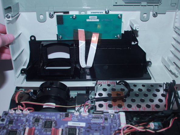

    • Using your finger gently move back and forth the JST cable that connects the top to the motherboard.
    • Now completely take off the top of the projector.

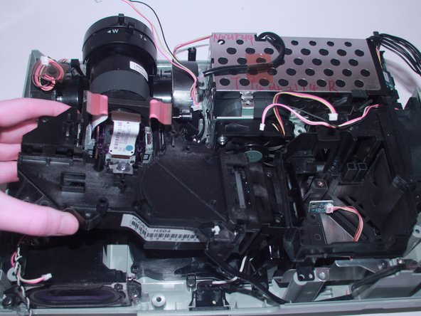

  9. Epson PowerLite  822 Plus Exhaust Fan Replacement: crwdns2935265:09crwdnd2935265:01crwdnd2935265:01crwdne2935265:0
    • Now, the motherboard is completely removed from the projector and you are ready to replace it.
  10. Epson PowerLite  822 Plus Exhaust Fan Replacement, Projector Lens: crwdns2935265:010crwdnd2935265:01crwdnd2935265:03crwdne2935265:0 Epson PowerLite  822 Plus Exhaust Fan Replacement, Projector Lens: crwdns2935265:010crwdnd2935265:02crwdnd2935265:03crwdne2935265:0 Epson PowerLite  822 Plus Exhaust Fan Replacement, Projector Lens: crwdns2935265:010crwdnd2935265:03crwdnd2935265:03crwdne2935265:0

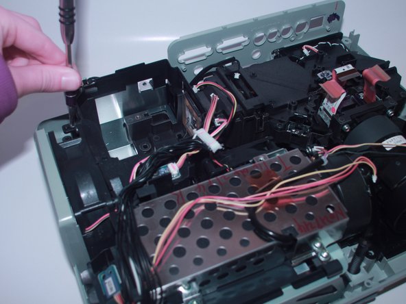

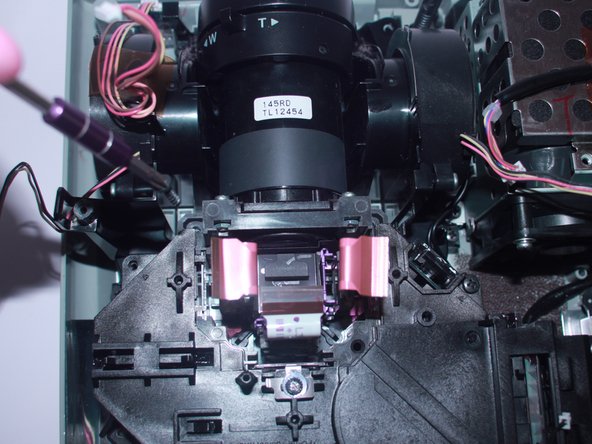

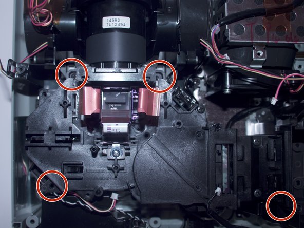

    • Unscrew the four 6mm screws that hold together the fan bracket.
  11. Epson PowerLite  822 Plus Exhaust Fan Replacement: crwdns2935265:011crwdnd2935265:01crwdnd2935265:02crwdne2935265:0 Epson PowerLite  822 Plus Exhaust Fan Replacement: crwdns2935265:011crwdnd2935265:02crwdnd2935265:02crwdne2935265:0
    • Unscrew the four 6mm screws that secure the projector.
  12. Epson PowerLite  822 Plus Exhaust Fan Replacement: crwdns2935265:012crwdnd2935265:01crwdnd2935265:02crwdne2935265:0 Epson PowerLite  822 Plus Exhaust Fan Replacement: crwdns2935265:012crwdnd2935265:02crwdnd2935265:02crwdne2935265:0

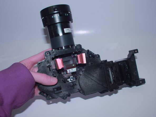

    • Pull out the loose projector.

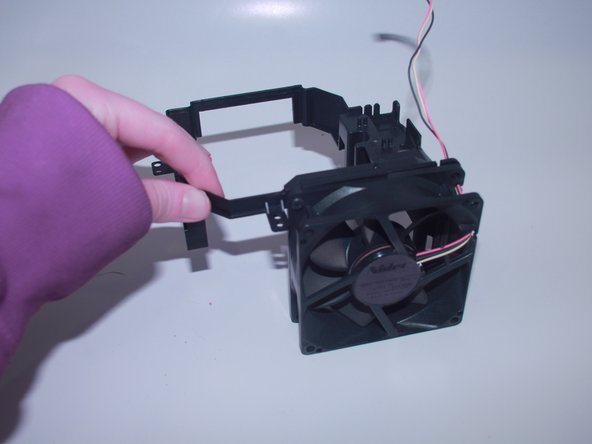

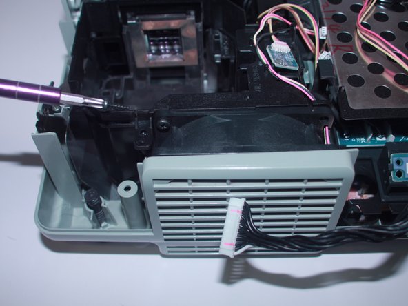

  13. Epson PowerLite  822 Plus Exhaust Fan Replacement, Exhaust Fan: crwdns2935265:013crwdnd2935265:01crwdnd2935265:02crwdne2935265:0 Epson PowerLite  822 Plus Exhaust Fan Replacement, Exhaust Fan: crwdns2935265:013crwdnd2935265:02crwdnd2935265:02crwdne2935265:0
    • Gently lift the fan bracket up and remove it and it is ready to be replaced.
