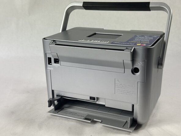

    • Ensure that the printer is off and unplugged to prevent harm or damage to printer before beginning the replacement.
    • Turn the printer to face its backside and move the handle to the top or front of printer.
  2. Epson PictureMate Pal PM 200 Ink Cartridge Replacement: crwdns2935265:02crwdnd2935265:01crwdnd2935265:02crwdne2935265:0 Epson PictureMate Pal PM 200 Ink Cartridge Replacement: crwdns2935265:02crwdnd2935265:02crwdnd2935265:02crwdne2935265:0

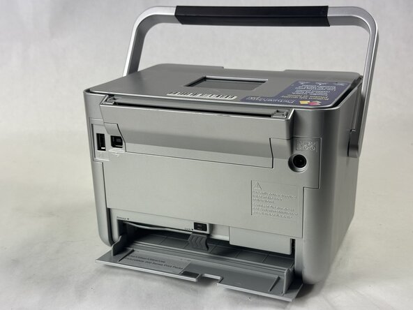

    • Open the back door by pulling down on the indent.
  3. Epson PictureMate Pal PM 200 Ink Cartridge Replacement: crwdns2935265:03crwdnd2935265:01crwdnd2935265:02crwdne2935265:0 Epson PictureMate Pal PM 200 Ink Cartridge Replacement: crwdns2935265:03crwdnd2935265:02crwdnd2935265:02crwdne2935265:0
    • Pull the lever to the left to disengage the cartridge from the printer.
    • Do not try to remove the cartridge before moving the lever.
