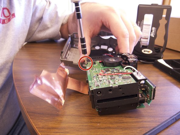

  5. Epson PPC650 Screen Replacement: crwdns2935265:05crwdnd2935265:01crwdnd2935265:03crwdne2935265:0 Epson PPC650 Screen Replacement: crwdns2935265:05crwdnd2935265:02crwdnd2935265:03crwdne2935265:0 Epson PPC650 Screen Replacement: crwdns2935265:05crwdnd2935265:03crwdnd2935265:03crwdne2935265:0
    • Separate the front and the back pieces of the camera's plastic casing using a spudger.
    • WARNING: When pulling the front plastic casing, be careful of the wires that are connected to the aperture control.
    • Use minimal force so that the plastic casing does not break.
    • When separating the small silver siding, the indicator for the view/off/playback may fall out.
    • The plastic viewing window located on the top of the camera may also become lose and fall out.

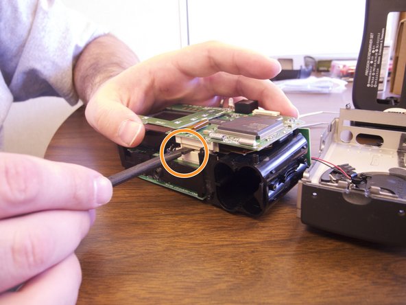

  6. Epson PPC650 Screen Replacement, Screen: crwdns2935265:06crwdnd2935265:01crwdnd2935265:03crwdne2935265:0 Epson PPC650 Screen Replacement, Screen: crwdns2935265:06crwdnd2935265:02crwdnd2935265:03crwdne2935265:0 Epson PPC650 Screen Replacement, Screen: crwdns2935265:06crwdnd2935265:03crwdnd2935265:03crwdne2935265:0
    • Remove the copper sheet from the front and back paneling.
    • Use the spudger to unsolder the copper paneling.
    • Use the spudger to separate the back circuit board from the camera.

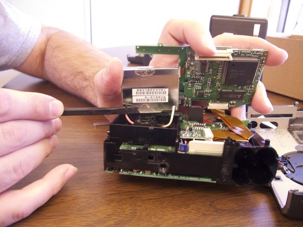

  7. Epson PPC650 Screen Replacement: crwdns2935265:07crwdnd2935265:01crwdnd2935265:02crwdne2935265:0 Epson PPC650 Screen Replacement: crwdns2935265:07crwdnd2935265:02crwdnd2935265:02crwdne2935265:0
    • The picture viewing screen is glued to the backing as well as wired in with pink and white wires.
    • Exert minimal force to pull the screen loose from the camera.
    • Remove the pink and white wiring from the internal paneling. These wires are soldered in.
    • Remove the orange data hookup cable that feeds into the back circuit board.
    • Once all wires have been detached and the old screen has been removed place the new screen into the camera.
    • Insert data hookup into the back of the camera and into the new screen.
    • Re-solder the new pink and white wire onto the internal circuit board.
