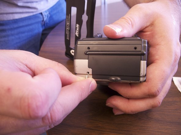

    • Remove the two screws on the rounded side of the camera.
  3. Epson PPC650 Camera Case Replacement: crwdns2935265:03crwdnd2935265:01crwdnd2935265:02crwdne2935265:0 Epson PPC650 Camera Case Replacement: crwdns2935265:03crwdnd2935265:02crwdnd2935265:02crwdne2935265:0
    • Remove the three screws on the flat side of the camera.
    • All of the silver screws go into the side of the camera that is silver.
    • All of the black screws go into the side of the camera that is black.
  4. Epson PPC650 Camera Case Replacement: crwdns2935265:04crwdnd2935265:01crwdnd2935265:01crwdne2935265:0
    • Remove the four screws from the bottom of the camera.

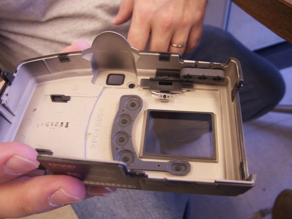

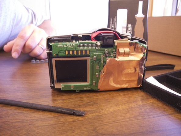

  5. Epson PPC650 Camera Case Replacement: crwdns2935265:05crwdnd2935265:01crwdnd2935265:03crwdne2935265:0 Epson PPC650 Camera Case Replacement: crwdns2935265:05crwdnd2935265:02crwdnd2935265:03crwdne2935265:0 Epson PPC650 Camera Case Replacement: crwdns2935265:05crwdnd2935265:03crwdnd2935265:03crwdne2935265:0
    • Separate the front and the back pieces of the camera's plastic casing using a spudger.
    • WARNING: When pulling the front plastic casing, be careful of the wires that are connected to the aperture control.
    • Use minimal force so that the plastic casing does not break.
    • When separating the small silver siding, the indicator for the view/off/playback may fall out.
    • The plastic viewing window located on the top of the camera may also become lose and fall out.
