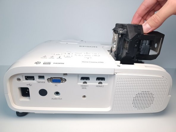

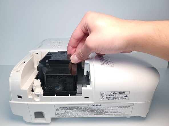

    • Loosen and remove the two screws holding the lamp.
    • Remove two 9 mm Phillips #2 screws.
  3. Epson Home Cinema 2150 Speaker Replacement: crwdns2935265:03crwdnd2935265:01crwdnd2935265:03crwdne2935265:0 Epson Home Cinema 2150 Speaker Replacement: crwdns2935265:03crwdnd2935265:02crwdnd2935265:03crwdne2935265:0 Epson Home Cinema 2150 Speaker Replacement: crwdns2935265:03crwdnd2935265:03crwdnd2935265:03crwdne2935265:0
    • Using four fingers, pull upwards on the lamp's plastic casing.
    • You may feel some resistance when pulling the lamp.

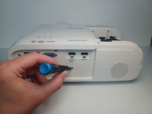

    • From the back of the projector remove three 6 mm Phillips #1 screws.

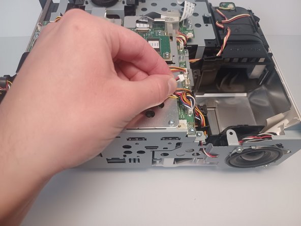

  15. Epson Home Cinema 2150 Speaker Replacement: crwdns2935265:015crwdnd2935265:01crwdnd2935265:02crwdne2935265:0 Epson Home Cinema 2150 Speaker Replacement: crwdns2935265:015crwdnd2935265:02crwdnd2935265:02crwdne2935265:0
    • Disconnect the speaker wire from the motherboard.
    • Pull up at the end of the wire when removing the connector.
