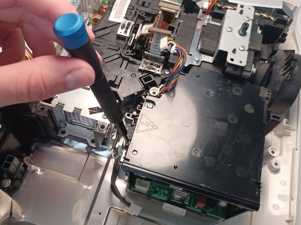

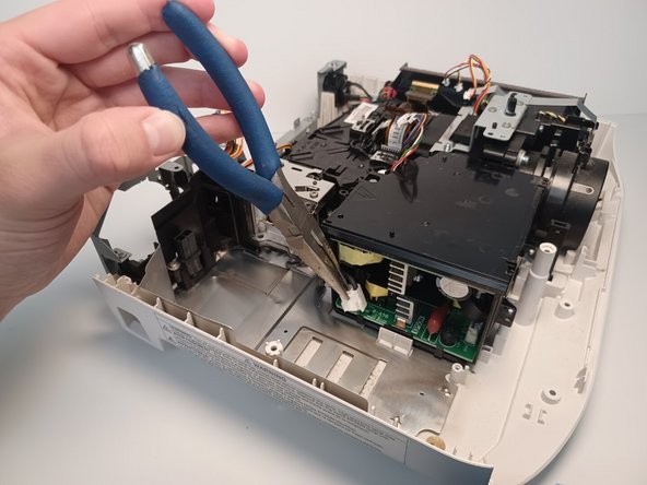

  29. Epson Home Cinema 2150 Repair Power Supply Unit Replacement, Power Supply Unit: crwdns2935265:029crwdnd2935265:01crwdnd2935265:03crwdne2935265:0 Epson Home Cinema 2150 Repair Power Supply Unit Replacement, Power Supply Unit: crwdns2935265:029crwdnd2935265:02crwdnd2935265:03crwdne2935265:0 Epson Home Cinema 2150 Repair Power Supply Unit Replacement, Power Supply Unit: crwdns2935265:029crwdnd2935265:03crwdnd2935265:03crwdne2935265:0
    • The power supply unit is a black box. Inside, there are two connected circuit boards, each with a single connector.
    • Using needle nose pliers, disconnect the first white connection cable from the circuit board.
    • Power suppl units have components that can hold an electric charge. Avoid touching anything other than the connector to avoid the risk of electric shock.
  30. Epson Home Cinema 2150 Repair Power Supply Unit Replacement: crwdns2935265:030crwdnd2935265:01crwdnd2935265:02crwdne2935265:0 Epson Home Cinema 2150 Repair Power Supply Unit Replacement: crwdns2935265:030crwdnd2935265:02crwdnd2935265:02crwdne2935265:0
    • From the rear side of the power supply unit, remove a single 9.5 mm Phillips #1 screw.

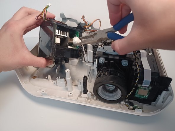

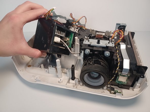

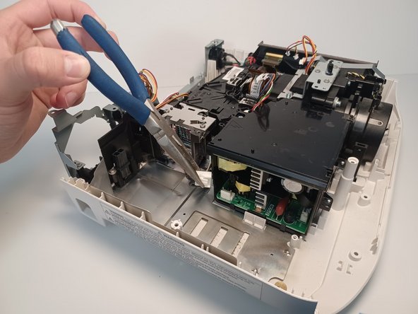

  31. Epson Home Cinema 2150 Repair Power Supply Unit Replacement: crwdns2935265:031crwdnd2935265:01crwdnd2935265:03crwdne2935265:0 Epson Home Cinema 2150 Repair Power Supply Unit Replacement: crwdns2935265:031crwdnd2935265:02crwdnd2935265:03crwdne2935265:0 Epson Home Cinema 2150 Repair Power Supply Unit Replacement: crwdns2935265:031crwdnd2935265:03crwdnd2935265:03crwdne2935265:0
    • Carefully lift the power supply unit 2-3 inches upwards without creating tension on the remaining wires.
    • Angle the power supply unit to the side for clear access to the remaining connector.
    • Using needle nose pliers, disconnect the remaining wires from the power supply connector.

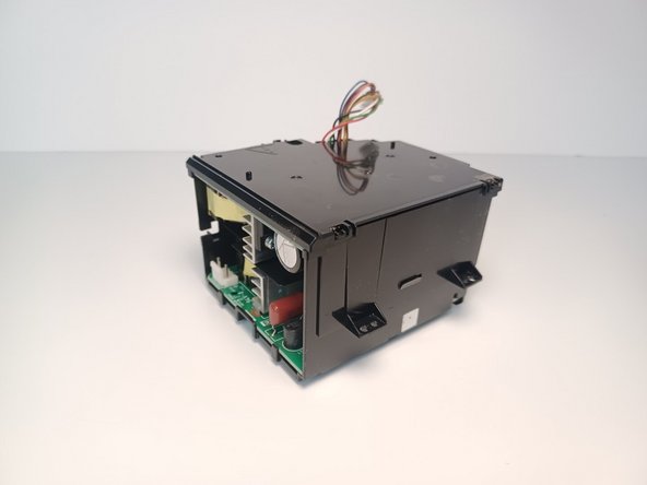

  32. Epson Home Cinema 2150 Repair Power Supply Unit Replacement: crwdns2935265:032crwdnd2935265:01crwdnd2935265:02crwdne2935265:0 Epson Home Cinema 2150 Repair Power Supply Unit Replacement: crwdns2935265:032crwdnd2935265:02crwdnd2935265:02crwdne2935265:0
    • Remove the power supply unit.
