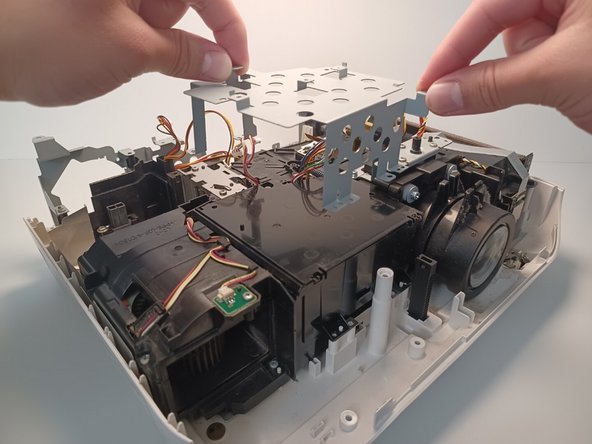

  24. Epson Home Cinema 2150 Exhaust Fan Replacement: crwdns2935265:024crwdnd2935265:01crwdnd2935265:03crwdne2935265:0 Epson Home Cinema 2150 Exhaust Fan Replacement: crwdns2935265:024crwdnd2935265:02crwdnd2935265:03crwdne2935265:0 Epson Home Cinema 2150 Exhaust Fan Replacement: crwdns2935265:024crwdnd2935265:03crwdnd2935265:03crwdne2935265:0
    • Remove five 9.5 mm Phillips #1 screws.
    • Remove one 6.0 mm Phillips #2 screw.
    • This screw is located to the right of the rear 9.5 mm screw.
    • Remove the metal bracket by pulling upwards on its sides.

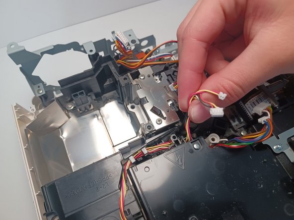

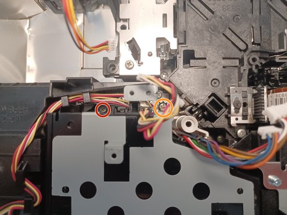

  25. Epson Home Cinema 2150 Exhaust Fan Replacement: crwdns2935265:025crwdnd2935265:01crwdnd2935265:03crwdne2935265:0 Epson Home Cinema 2150 Exhaust Fan Replacement: crwdns2935265:025crwdnd2935265:02crwdnd2935265:03crwdne2935265:0 Epson Home Cinema 2150 Exhaust Fan Replacement: crwdns2935265:025crwdnd2935265:03crwdnd2935265:03crwdne2935265:0
    • Remove the 9.5 mm Phillips #1 screw located behind the power supply.
    • Unwind the fan cable from the power supply for better access to the screw.
    • Remove the 10 mm Phillips #1 screw.

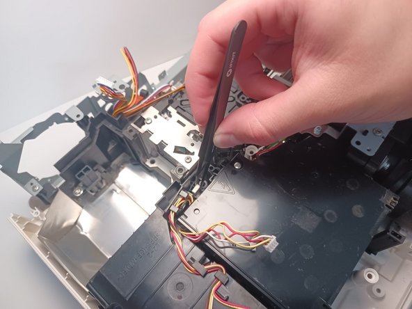

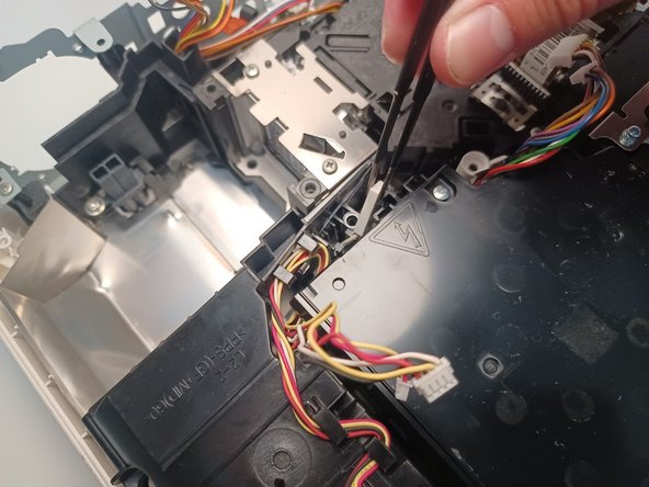

  26. Epson Home Cinema 2150 Exhaust Fan Replacement: crwdns2935265:026crwdnd2935265:01crwdnd2935265:03crwdne2935265:0 Epson Home Cinema 2150 Exhaust Fan Replacement: crwdns2935265:026crwdnd2935265:02crwdnd2935265:03crwdne2935265:0 Epson Home Cinema 2150 Exhaust Fan Replacement: crwdns2935265:026crwdnd2935265:03crwdnd2935265:03crwdne2935265:0
    • Move the fan cable to the side for clear access to the sensor below it.
    • Using pliers, pull upwards on the white sensor to remove it from the fan assembly.

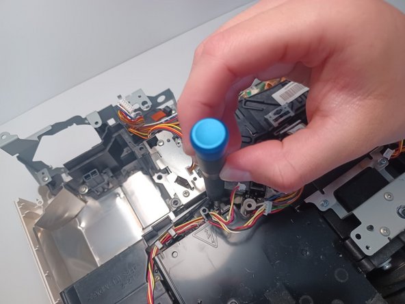

  27. Epson Home Cinema 2150 Exhaust Fan Replacement: crwdns2935265:027crwdnd2935265:01crwdnd2935265:03crwdne2935265:0 Epson Home Cinema 2150 Exhaust Fan Replacement: crwdns2935265:027crwdnd2935265:02crwdnd2935265:03crwdne2935265:0 Epson Home Cinema 2150 Exhaust Fan Replacement: crwdns2935265:027crwdnd2935265:03crwdnd2935265:03crwdne2935265:0
    • Remove two 9.5mm Phillips #1 screws.
