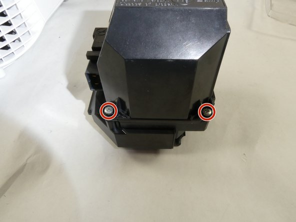

  2. Epson Home Cinema 1060 Bulb Replacement: crwdns2935265:02crwdnd2935265:01crwdnd2935265:02crwdne2935265:0 Epson Home Cinema 1060 Bulb Replacement: crwdns2935265:02crwdnd2935265:02crwdnd2935265:02crwdne2935265:0
    • Remove the two screws from the top of the black casing using a Phillips #0 screwdriver.
    • Pull the casing out of its chamber.

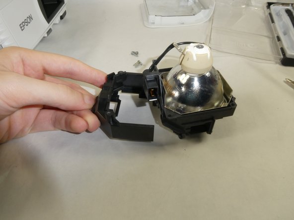

  4. Epson Home Cinema 1060 Bulb Replacement: crwdns2935265:04crwdnd2935265:01crwdnd2935265:02crwdne2935265:0 Epson Home Cinema 1060 Bulb Replacement: crwdns2935265:04crwdnd2935265:02crwdnd2935265:02crwdne2935265:0
    • Remove the top and side of the casing from the bulb.
    • Remove the old light build and replace it with your new one.
