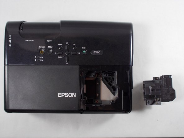

Epson EX90 Lamp Replacement
  1. Epson EX90 Lamp Replacement, Lamp: crwdns2935265:01crwdnd2935265:01crwdnd2935265:01crwdne2935265:0
    • Turn off the projector and unplug the power cable.
    • Allow the projector to cool down for at least one hour (or until the lamp is cool).
  2. Epson EX90 Lamp Replacement: crwdns2935265:02crwdnd2935265:01crwdnd2935265:01crwdne2935265:0
    • Loosen the screw holding the lamp cover on top of the projector.
    • Slide the cover out of the projector.
  3. Epson EX90 Lamp Replacement: crwdns2935265:03crwdnd2935265:01crwdnd2935265:02crwdne2935265:0 Epson EX90 Lamp Replacement: crwdns2935265:03crwdnd2935265:02crwdnd2935265:02crwdne2935265:0
    • Loosen the two captive screws holding the lamp in place.
    • Use your hands to pull the lamp straight up and out of the projector.
