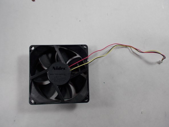

  4. Epson EX90 Cooling Fan Replacement: crwdns2935265:04crwdnd2935265:01crwdnd2935265:02crwdne2935265:0 Epson EX90 Cooling Fan Replacement: crwdns2935265:04crwdnd2935265:02crwdnd2935265:02crwdne2935265:0
    • Remove fan and related assembly from projector.
    • Detach fan from housing.
    • If the fan is still in good condition, use a paper towel or cloth and clean out all the dust on your fan before reassembling.
