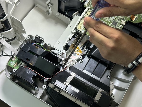

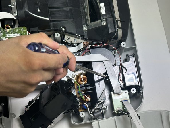

    • Remove the 11 mm screws from the bottom of the device using a long-handle Phillips screwdriver.
  2. Epson BrightLink 450wi Screen Replacement: crwdns2935265:02crwdnd2935265:01crwdnd2935265:03crwdne2935265:0 Epson BrightLink 450wi Screen Replacement: crwdns2935265:02crwdnd2935265:02crwdnd2935265:03crwdne2935265:0 Epson BrightLink 450wi Screen Replacement: crwdns2935265:02crwdnd2935265:03crwdnd2935265:03crwdne2935265:0

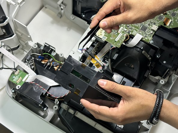

    • Remove the 11 mm screws from the air filter section and power source section.
  3. Epson BrightLink 450wi Screen Replacement: crwdns2935265:03crwdnd2935265:01crwdnd2935265:03crwdne2935265:0 Epson BrightLink 450wi Screen Replacement: crwdns2935265:03crwdnd2935265:02crwdnd2935265:03crwdne2935265:0 Epson BrightLink 450wi Screen Replacement: crwdns2935265:03crwdnd2935265:03crwdnd2935265:03crwdne2935265:0

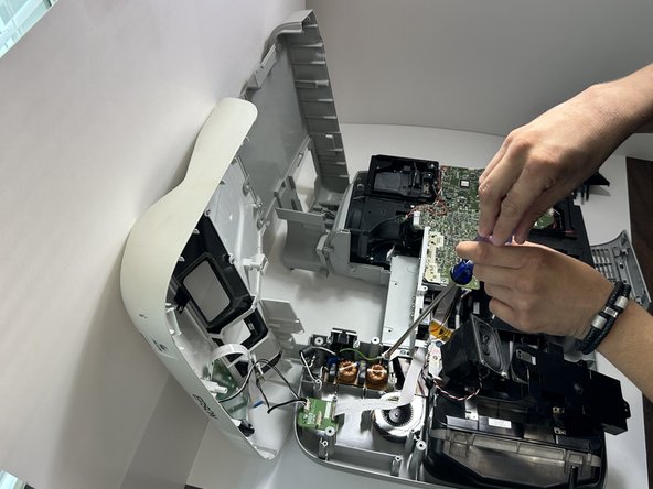

    • Remove the 11 mm screws around the speaker. Use tweezers to move wires out of the way to locate screws.
  4. Epson BrightLink 450wi Screen Replacement: crwdns2935265:04crwdnd2935265:01crwdnd2935265:02crwdne2935265:0 Epson BrightLink 450wi Screen Replacement: crwdns2935265:04crwdnd2935265:02crwdnd2935265:02crwdne2935265:0

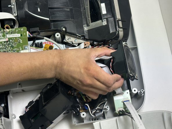

    • Once the screws are removed, the speaker can be removed.
  5. Epson BrightLink 450wi Screen Replacement, Screen: crwdns2935265:05crwdnd2935265:01crwdnd2935265:03crwdne2935265:0 Epson BrightLink 450wi Screen Replacement, Screen: crwdns2935265:05crwdnd2935265:02crwdnd2935265:03crwdne2935265:0 Epson BrightLink 450wi Screen Replacement, Screen: crwdns2935265:05crwdnd2935265:03crwdnd2935265:03crwdne2935265:0

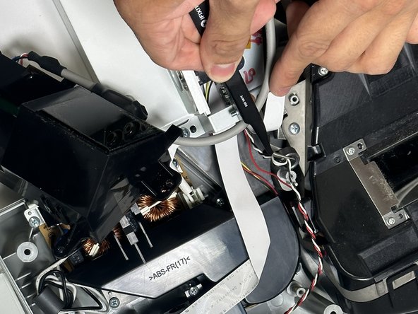

    • Using Phillips screwdriver unscrew the screws to the screen.
  6. Epson BrightLink 450wi Screen Replacement: crwdns2935265:06crwdnd2935265:01crwdnd2935265:02crwdne2935265:0 Epson BrightLink 450wi Screen Replacement: crwdns2935265:06crwdnd2935265:02crwdnd2935265:02crwdne2935265:0

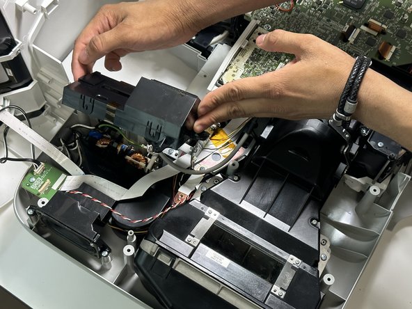

    • Gently lift the screen up after the screws are removed.
  7. Epson BrightLink 450wi Screen Replacement: crwdns2935265:07crwdnd2935265:01crwdnd2935265:02crwdne2935265:0 Epson BrightLink 450wi Screen Replacement: crwdns2935265:07crwdnd2935265:02crwdnd2935265:02crwdne2935265:0
    • Using the tweezers remove the wire to the back of the screen.
