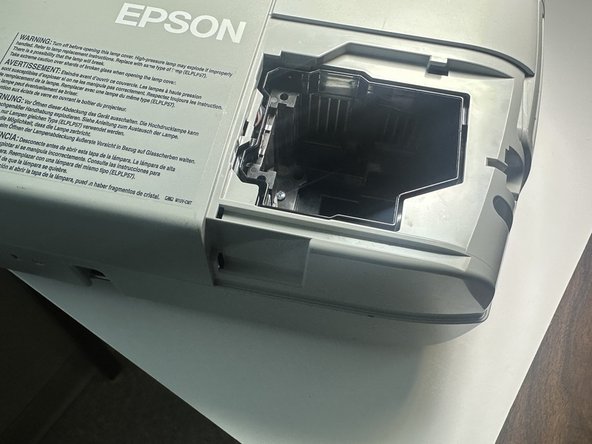

  2. Epson BrightLink 450wi Projector Lamp Replacement: crwdns2935265:02crwdnd2935265:01crwdnd2935265:01crwdne2935265:0
    • Once the screw is no longer tightened remove the cover plate by sliding it off towards the right of the device. This will expose the lamp.

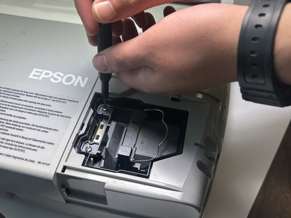

  3. Epson BrightLink 450wi Projector Lamp Replacement: crwdns2935265:03crwdnd2935265:01crwdnd2935265:02crwdne2935265:0 Epson BrightLink 450wi Projector Lamp Replacement: crwdns2935265:03crwdnd2935265:02crwdnd2935265:02crwdne2935265:0
    • Unscrew the two 11mm screws on the left of the lamp component.
    • These captive screws will also only unscrew enough to come loose but not to enough to be removed.

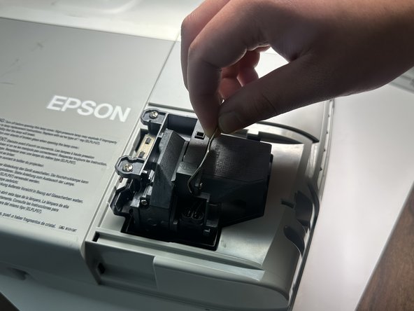

  4. Epson BrightLink 450wi Projector Lamp Replacement: crwdns2935265:04crwdnd2935265:01crwdnd2935265:03crwdne2935265:0 Epson BrightLink 450wi Projector Lamp Replacement: crwdns2935265:04crwdnd2935265:02crwdnd2935265:03crwdne2935265:0 Epson BrightLink 450wi Projector Lamp Replacement: crwdns2935265:04crwdnd2935265:03crwdnd2935265:03crwdne2935265:0
    • Once the screws are loose you can lift the thin metal handle upwards. Use it as leverage to pull the lamp straight out to remove it.
