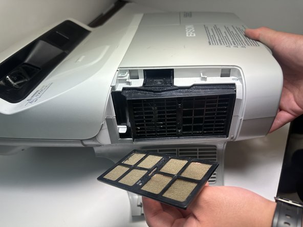

    • Rotate the projector on its side with the Wi-Fi symbol and sliding lock facing you.
  2. Epson BrightLink 450Wi Air Filter Replacement: crwdns2935265:02crwdnd2935265:01crwdnd2935265:03crwdne2935265:0 Epson BrightLink 450Wi Air Filter Replacement: crwdns2935265:02crwdnd2935265:02crwdnd2935265:03crwdne2935265:0 Epson BrightLink 450Wi Air Filter Replacement: crwdns2935265:02crwdnd2935265:03crwdnd2935265:03crwdne2935265:0
    • Pull back the sliding lock in the direction away from the projector, and gently open the air filter door while still holding the lock open.

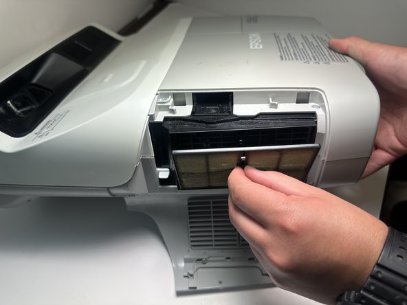

    • Grab the air filter center tab, and pull it gently away from the projector.
    • Replace the filter by slotting in a new filter the same way it was pulled out.
