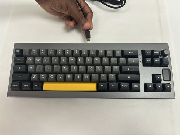

    • Power off the keyboard and disconnect any USB cable.
    • Place the keyboard on a clean, static-free workspace.

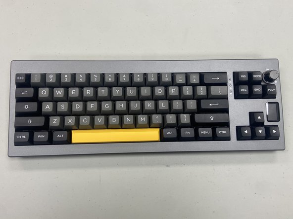

  2. Epomaker Shadow-X Switch Plate Re-alignment: crwdns2935265:02crwdnd2935265:01crwdnd2935265:01crwdne2935265:0
    • Use a keycap puller/spudger to remove all keycaps on the keyboard.

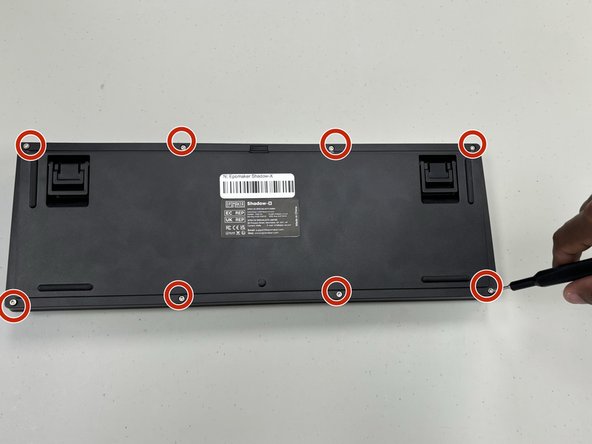

  3. Epomaker Shadow-X Switch Plate Re-alignment: crwdns2935265:03crwdnd2935265:01crwdnd2935265:01crwdne2935265:0
    • Remove the screws on the back of the keyboard with a hex screwdriver.
    • Carefully pry open the case using a plastic opening tool or spudger, and separate the top and bottom halves.

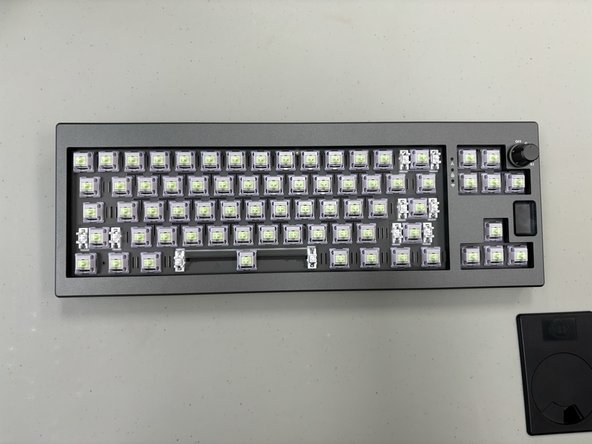

  4. Epomaker Shadow-X Switch Plate Re-alignment: crwdns2935265:04crwdnd2935265:01crwdnd2935265:01crwdne2935265:0
    • Locate the switch plate, which sits between the key switches and the PCB.
    • If the switch plate is misaligned, carefully adjust it so that it sits flush and aligns with all switch positions.
    • Ensure that each switch slot in the plate lines up with the PCB holes below it.
