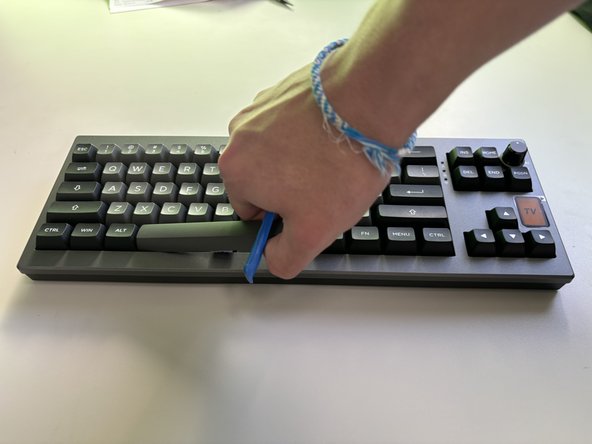

    • Place the tool around the keycap, with the prongs on opposite sides of the key.
    • Gently pull the keycap up and off the switch stem.
    • Avoid pulling at an angle to prevent damaging the stem or keycap.

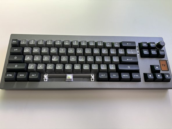

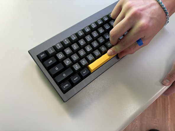

    • For larger keys, such as the Spacebar, Shift, or Enter, insert the puller evenly on both sides.
    • If using a pry tool, pry the middle first, then evenly on both sides.
    • Lift gently, using tweezers to stabilize any clips if necessary to prevent them from snapping.

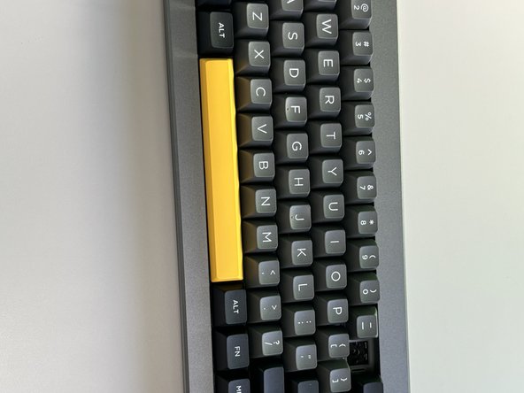

    • Align the new keycaps, positioning the new keycaps over the switch stem, making sure it's centered.
    • Press straight down, applying even pressure until the keycap clicks into place.

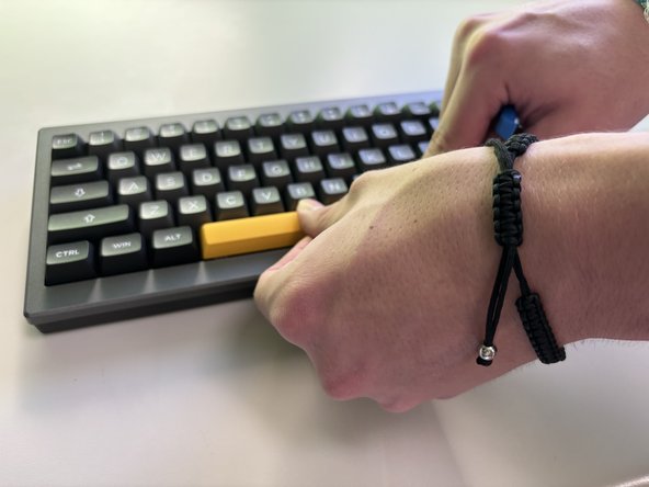

    • Once all keycaps are installed, reconnect the keyboard to power and test each key for proper fit and function.
You have successfully replaced the keycaps on your Epomaker Shadow-X keyboard! The new keycaps should enhance both the aesthetic and feel of your keyboard. Test each key to ensure they are securely attached and functioning smoothly, and enjoy the refreshed look of your setup.
