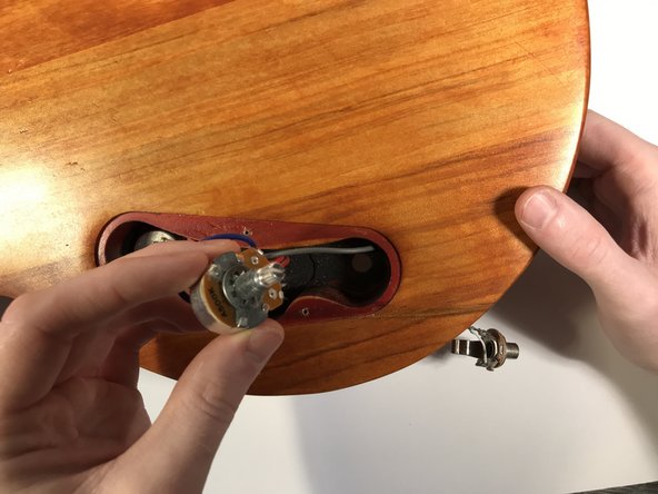

    • Pull out the tone control.
  7. Epiphone Les Paul Special Input Jack Replacement: crwdns2935265:07crwdnd2935265:01crwdnd2935265:02crwdne2935265:0 Epiphone Les Paul Special Input Jack Replacement: crwdns2935265:07crwdnd2935265:02crwdnd2935265:02crwdne2935265:0
    • Push the input jack through the body and pull it out.

    • Desolder the wires from the input jack.

    • Solder the wires to the input jack.
    • Repeat steps 7-1 in reverse order to put it all back together.
To get everything back into its original place, follow steps 1-7 in reverse order.
