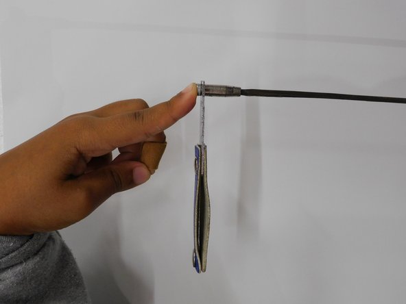

      • Plug the epee body cord into the socket on one end and the test box on the other.
      • Hold your epee upright and place the weight gently onto the point.
      • The tip may depress beneath the weight. If it does not, press down on the top of the weight.
      • The green light on the test box should light up, then turn off.

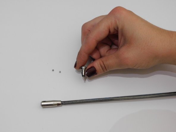

      • If your point failed any of the previous tests, you must disassemble it to adjust or replace parts.
      • Depress the tip while unscrewing both tip screws. Remove the tip, and then remove the pressure spring.
      • You can use the tip of your screwdriver to catch the edge of the pressure spring if it seems stuck.
      • While the tip is disassembled, take the opportunity to clean it with isopropyl alcohol and a Q-tip if you have not cleaned it recently.

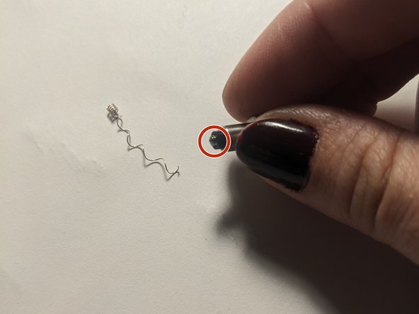

      • If your epee fails either of the test gauges, this means that your contact spring is likely the culprit, and will need to be adjusted or replaced.
      • If you fail the smaller test gauge this means that your contact spring is too long. Twist the contact spring a rotation or two up the post.
      • If you fail the larger test gauge, this means that your contact spring is too short. Gently stretch the spring, or replace it entirely.
      • To remove the contact spring, pull it off the post. The post is the small threaded cylinder sticking out from the tip.
      • Twist a new spring onto the post while applying pressure. Make sure your new spring catches on the grooves of the post.
      • If this still does not solve the issue there may be a foreign object inside your point. Hold your weapon with the point toward the ground and gently tap to remove any foreign object that may be preventing your contact spring from touching the contacts.

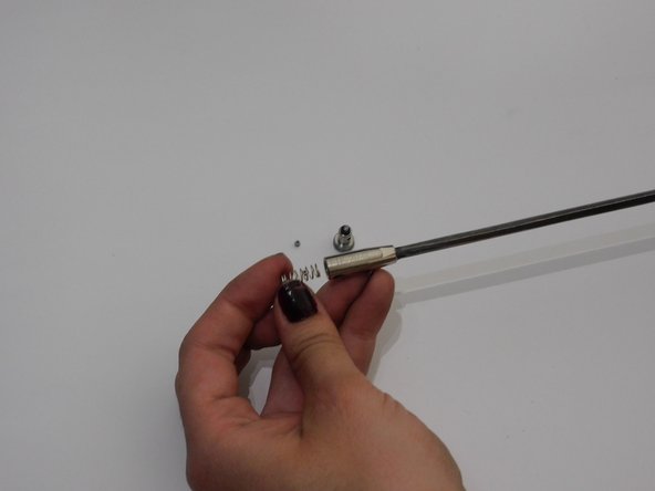

    7. Epee Point Spring Replacement: crwdns2935265:07crwdnd2935265:01crwdnd2935265:03crwdne2935265:0 Epee Point Spring Replacement: crwdns2935265:07crwdnd2935265:02crwdnd2935265:03crwdne2935265:0 Epee Point Spring Replacement: crwdns2935265:07crwdnd2935265:03crwdnd2935265:03crwdne2935265:0
      • Place the tip back onto the barrel, ensuring that the contact spring is sitting inside the pressure spring.
      • While holding the tip in place, pick up the NEPS screw with the tip of your NEPS screwdriver.
      • Depress the tip and rotate it so that the threaded hole in the tip, meant for the tip screw, aligns with the channel on the point barrel.
      • Insert the NEPS screw with the tip of your screwdriver and tighten it clockwise.
      • Be careful not to over-tighten after the screw is securely in place to avoid breaking off the tip of your NEPS screwdriver.
      • After your point is reassembled, go back through steps one through three, to retest your point.
