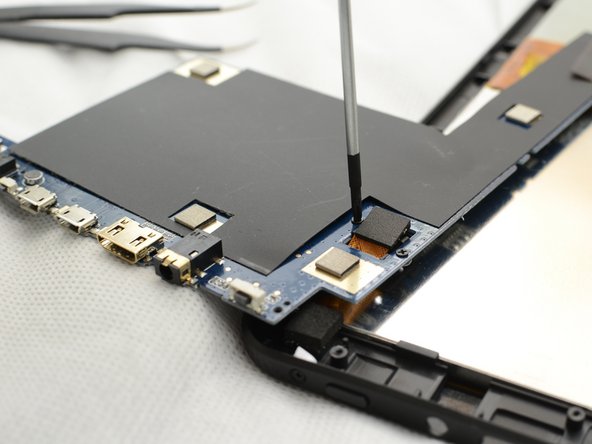

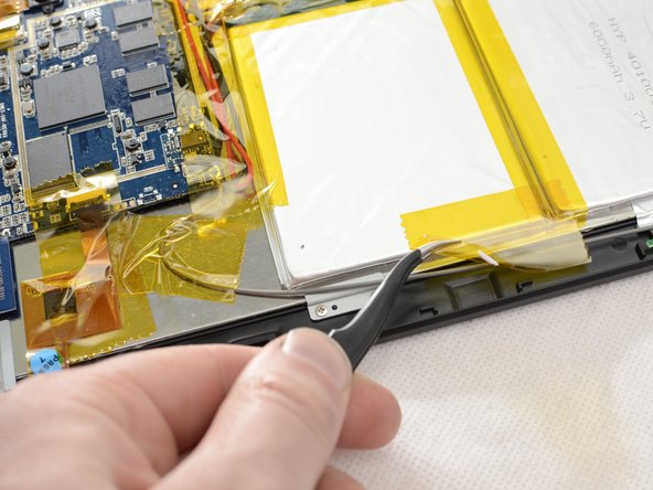

    • Remove the non-conductive tape located on the battery and motherboard assembly.
  4. Envizen V100M Rear Facing Camera Replacement: crwdns2935265:04crwdnd2935265:01crwdnd2935265:03crwdne2935265:0 Envizen V100M Rear Facing Camera Replacement: crwdns2935265:04crwdnd2935265:02crwdnd2935265:03crwdne2935265:0 Envizen V100M Rear Facing Camera Replacement: crwdns2935265:04crwdnd2935265:03crwdnd2935265:03crwdne2935265:0
    • Slide the ifixit spudger under the battery, and work down the side of the battery, releasing it from the adhesive holding it down.
    • Remove battery from the Envizen V100M.

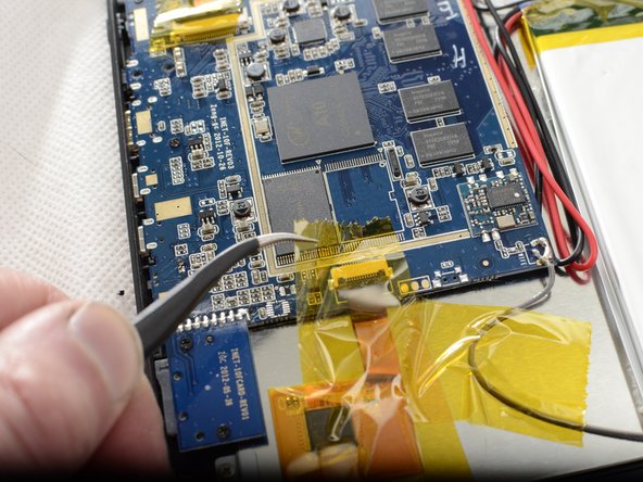

    • Remove the three ribbon cables from their couplings
    • Using the prying tool gently push the bracket up, allowing for the cable to right out.
  8. Envizen V100M Rear Facing Camera Replacement: crwdns2935265:08crwdnd2935265:01crwdnd2935265:01crwdne2935265:0
    • Remove the solder holding the white ribbon cable in place, here is a guide on how to solder.
    • Then flip the motherboard over to access the screws for the rear facing camera.
    • Be very careful that you doe not tear the wires for the camera. gently flip the motherboard making sure to not stress out the wires.
