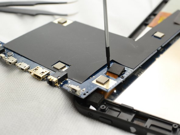

    • Remove the non-conductive tape located on the battery and motherboard assembly.

  7. Envizen V100M LCD Screen Replacement, Motherboard: crwdns2935265:07crwdnd2935265:01crwdnd2935265:02crwdne2935265:0 Envizen V100M LCD Screen Replacement, Motherboard: crwdns2935265:07crwdnd2935265:02crwdnd2935265:02crwdne2935265:0
    • Remove the five screws holding the motherboard assembly down using the ifixit PH00 screwdriver
    • These screws are also 1.5mm in diameter and 3.5mm long

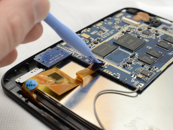

  8. Envizen V100M LCD Screen Replacement: crwdns2935265:08crwdnd2935265:01crwdnd2935265:02crwdne2935265:0 Envizen V100M LCD Screen Replacement: crwdns2935265:08crwdnd2935265:02crwdnd2935265:02crwdne2935265:0
    • Remove the three ribbon cables from their couplings.
    • Using the prying tool gently push the bracket up, allowing for the cable to right out.

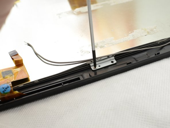

  15. Envizen V100M LCD Screen Replacement, LCD Screen: crwdns2935265:015crwdnd2935265:01crwdnd2935265:02crwdne2935265:0 Envizen V100M LCD Screen Replacement, LCD Screen: crwdns2935265:015crwdnd2935265:02crwdnd2935265:02crwdne2935265:0
    • Remove the six brackets around the outside of the LCD screen using the ifixit PH00 screwdriver
    • The 12 screws holding down the mounting brackets are 1.5mm in diameter and 2.8mm long

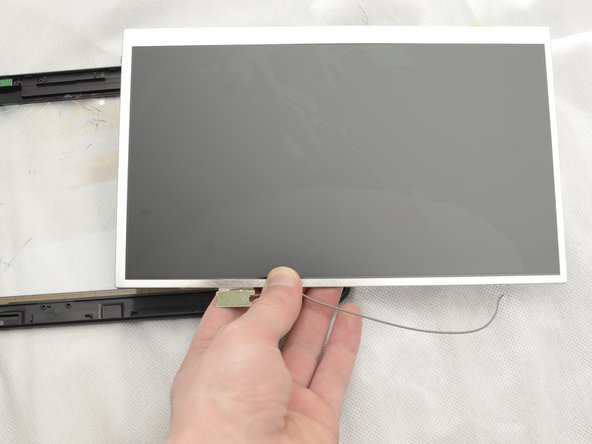

  16. Envizen V100M LCD Screen Replacement: crwdns2935265:016crwdnd2935265:01crwdnd2935265:02crwdne2935265:0 Envizen V100M LCD Screen Replacement: crwdns2935265:016crwdnd2935265:02crwdnd2935265:02crwdne2935265:0
    • The LCD can now be removed from the plastic tablet housing.
