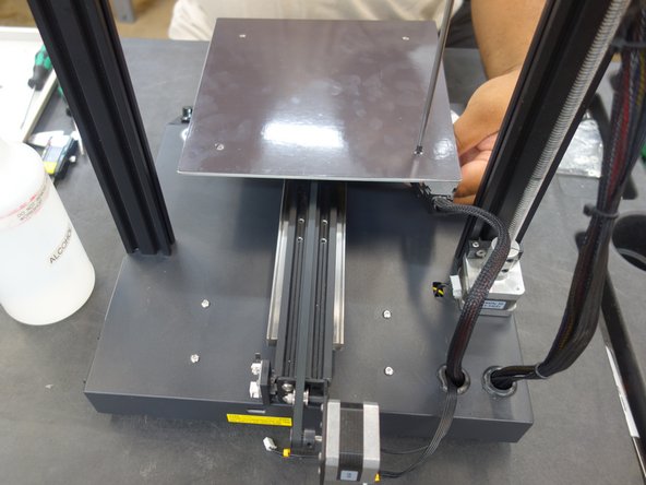

Ender 3 / CR20/PRO Y axis Linear rail kit install
  1. Ender 3 / CR20/PRO Y axis Linear rail kit install, Teardown: crwdns2935265:01crwdnd2935265:01crwdnd2935265:02crwdne2935265:0 Ender 3 / CR20/PRO Y axis Linear rail kit install, Teardown: crwdns2935265:01crwdnd2935265:02crwdnd2935265:02crwdne2935265:0

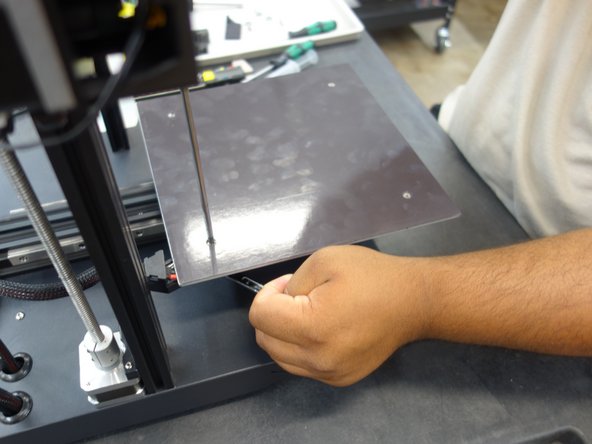

    • Remove all 4 bed leveling screws for the Bed heater.
    • Lift the bed heater and set it behind or to the left of the printer

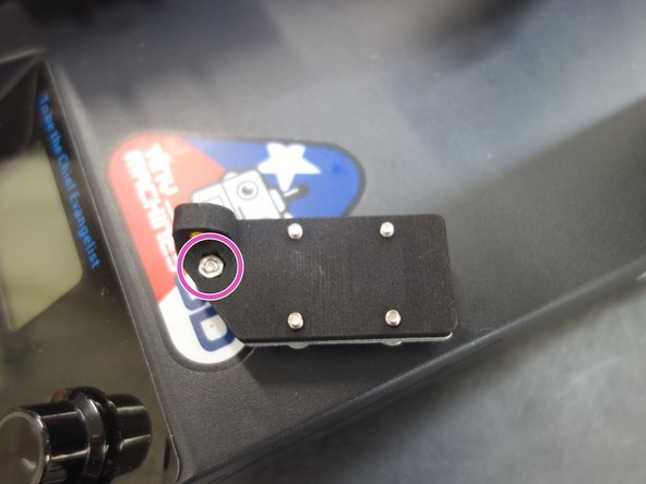

    • Remove all 4 idler pulley bracket screws
    • Lift pulley bracket to remove tension on the belt
    • Remove Y belt
    • Remove idler pulley bracket and set aside all parts

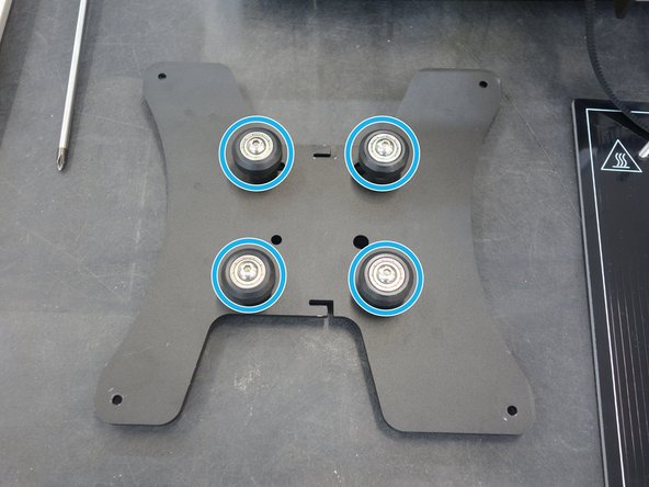

  3. Ender 3 / CR20/PRO Y axis Linear rail kit install, Y Carriage: crwdns2935265:03crwdnd2935265:01crwdnd2935265:03crwdne2935265:0 Ender 3 / CR20/PRO Y axis Linear rail kit install, Y Carriage: crwdns2935265:03crwdnd2935265:02crwdnd2935265:03crwdne2935265:0 Ender 3 / CR20/PRO Y axis Linear rail kit install, Y Carriage: crwdns2935265:03crwdnd2935265:03crwdnd2935265:03crwdne2935265:0
    • Slide off Y carriage of the front of the Y axis extrusion
    • Remove V-Slots wheels

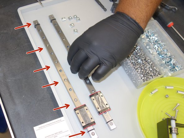

    • Remove Linear Rails for packaging and Wipe off excess oil with a lint free cloth
    • Preinstall M3x8 SHCS and Sliding Tnuts
    • Take Note to skip 2 holes between each fastener, and ensure to mirror this process from each end of the rail until you overlap in the middle

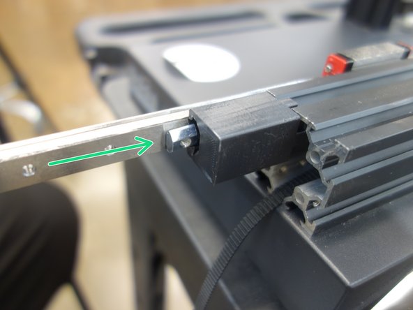

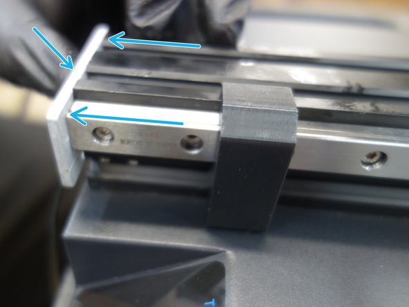

  5. Ender 3 / CR20/PRO Y axis Linear rail kit install, Slide On & Mount Rails: crwdns2935265:05crwdnd2935265:01crwdnd2935265:03crwdne2935265:0 Ender 3 / CR20/PRO Y axis Linear rail kit install, Slide On & Mount Rails: crwdns2935265:05crwdnd2935265:02crwdnd2935265:03crwdne2935265:0 Ender 3 / CR20/PRO Y axis Linear rail kit install, Slide On & Mount Rails: crwdns2935265:05crwdnd2935265:03crwdnd2935265:03crwdne2935265:0

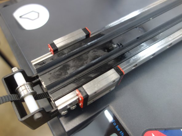

    • Note Sliding in the Linear rails do not allow rail block to slide off the end of the rails.
    • Insert Printed T-nut guide to help with sliding the rail into the top slot on the Y axis extrusion
    • Slide the rails into the top T-slot
    • Aline rails with the end of the extrusion using one of the included stiffener plates as a stop

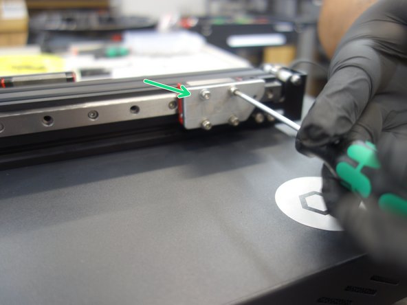

  6. Ender 3 / CR20/PRO Y axis Linear rail kit install, Mount Rails: crwdns2935265:06crwdnd2935265:01crwdnd2935265:02crwdne2935265:0 Ender 3 / CR20/PRO Y axis Linear rail kit install, Mount Rails: crwdns2935265:06crwdnd2935265:02crwdnd2935265:02crwdne2935265:0
    • Note when sliding on Rail alignment Jigs do not allow Linear rail block to slide off the end of the rails.
    • Tighten the M3 mounting bolts to the front of the rail to the back on both sides

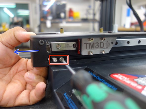

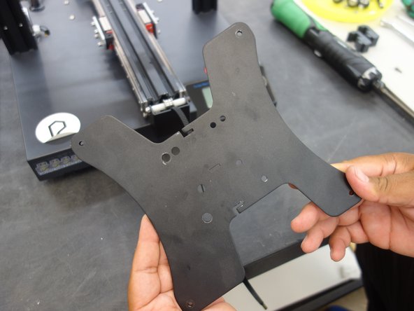

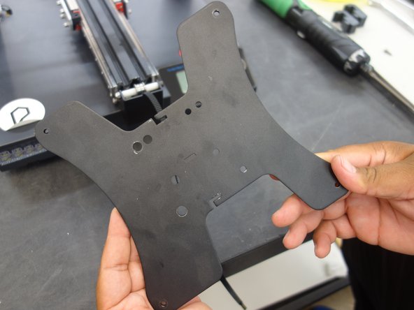

  8. Ender 3 / CR20/PRO Y axis Linear rail kit install, Mounting Rail Carriage Adaptors: crwdns2935265:08crwdnd2935265:01crwdnd2935265:02crwdne2935265:0 Ender 3 / CR20/PRO Y axis Linear rail kit install, Mounting Rail Carriage Adaptors: crwdns2935265:08crwdnd2935265:02crwdnd2935265:02crwdne2935265:0
    • Right side
    • Left side

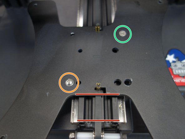

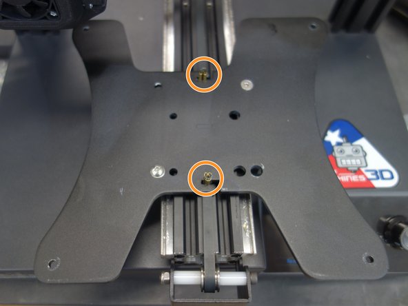

  9. Ender 3 / CR20/PRO Y axis Linear rail kit install, Y Carriage Install: crwdns2935265:09crwdnd2935265:01crwdnd2935265:03crwdne2935265:0 Ender 3 / CR20/PRO Y axis Linear rail kit install, Y Carriage Install: crwdns2935265:09crwdnd2935265:02crwdnd2935265:03crwdne2935265:0 Ender 3 / CR20/PRO Y axis Linear rail kit install, Y Carriage Install: crwdns2935265:09crwdnd2935265:03crwdnd2935265:03crwdne2935265:0
    • M4x10 FHCS
    • M4x12 BHCS
    • M4 washer
    • M4 washer large OD
    • M4 FHCS screw first. Then attach the M4x14S BHCS screw with the washer Stack.
    • Slide the Y Carriage forward and check that Y Carriage is parallel to that front of the Y extrusion. Then tight the screws fully.

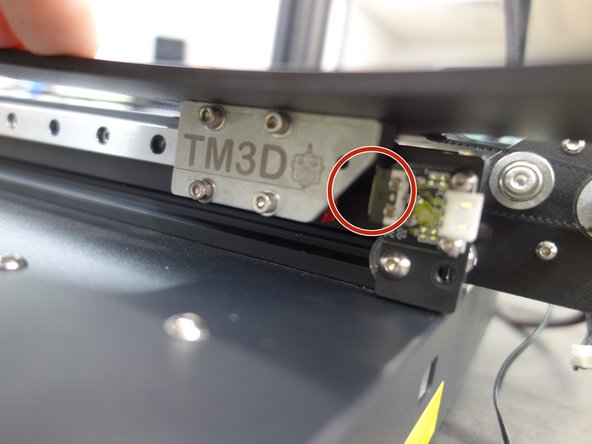

  10. Ender 3 / CR20/PRO Y axis Linear rail kit install, Y Endstop Spacer: crwdns2935265:010crwdnd2935265:01crwdnd2935265:03crwdne2935265:0 Ender 3 / CR20/PRO Y axis Linear rail kit install, Y Endstop Spacer: crwdns2935265:010crwdnd2935265:02crwdnd2935265:03crwdne2935265:0 Ender 3 / CR20/PRO Y axis Linear rail kit install, Y Endstop Spacer: crwdns2935265:010crwdnd2935265:03crwdnd2935265:03crwdne2935265:0
    • Install this spacer between the Endstop bracket extrusion
    • Check that the y endstop is triggered by the Adaptor plate
