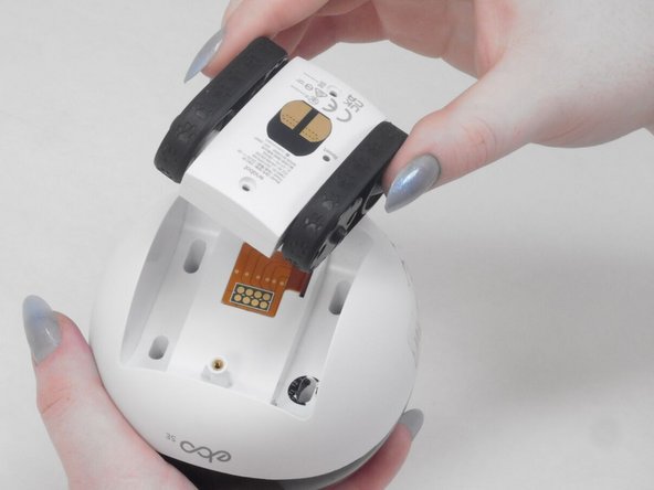

  3. Enabot EBO SE Wheels Replacement: crwdns2935265:03crwdnd2935265:01crwdnd2935265:02crwdne2935265:0 Enabot EBO SE Wheels Replacement: crwdns2935265:03crwdnd2935265:02crwdnd2935265:02crwdne2935265:0
    • Pull the wheel assembly towards you so it comes straight off without resistance.
    • If there is resistance, make sure to apply gentle force when pulling as it can get damaged with too much force.

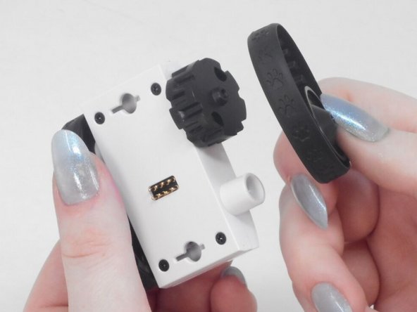

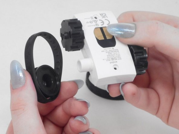

  4. Enabot EBO SE Wheels Replacement, Wheels: crwdns2935265:04crwdnd2935265:01crwdnd2935265:02crwdne2935265:0 Enabot EBO SE Wheels Replacement, Wheels: crwdns2935265:04crwdnd2935265:02crwdnd2935265:02crwdne2935265:0
    • Pull on the tire tread perpendicularly to the wheels to remove the tread.
    • The wheel should naturally come off with it for replacement.
  5. Enabot EBO SE Wheels Replacement: crwdns2935265:05crwdnd2935265:01crwdnd2935265:02crwdne2935265:0 Enabot EBO SE Wheels Replacement: crwdns2935265:05crwdnd2935265:02crwdnd2935265:02crwdne2935265:0
    • Repeat previous step with the wheels on the other side.
