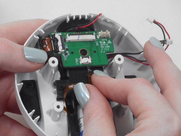

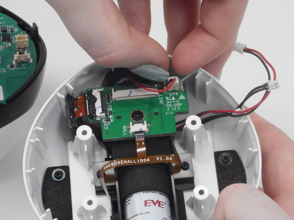

  9. Enabot EBO SE Speaker Replacement, Battery: crwdns2935265:09crwdnd2935265:01crwdnd2935265:03crwdne2935265:0 Enabot EBO SE Speaker Replacement, Battery: crwdns2935265:09crwdnd2935265:02crwdnd2935265:03crwdne2935265:0 Enabot EBO SE Speaker Replacement, Battery: crwdns2935265:09crwdnd2935265:03crwdnd2935265:03crwdne2935265:0
    • Use the iFixit opening tool or your fingernail to disconnect the cable by placing the edge underneath the gray tab.
    • Flip the tab up and pull the ribbon cable out.

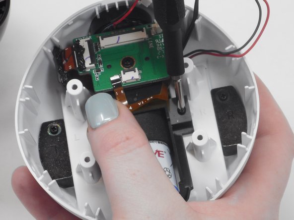

    • Disconnect the red and blue wires from the daughterboard by using your finger nails to pull up on the connector to disconnect.

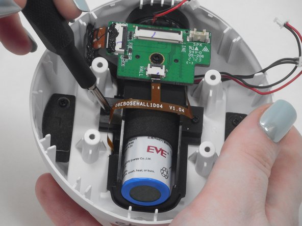

  10. Enabot EBO SE Speaker Replacement: crwdns2935265:010crwdnd2935265:01crwdnd2935265:03crwdne2935265:0 Enabot EBO SE Speaker Replacement: crwdns2935265:010crwdnd2935265:02crwdnd2935265:03crwdne2935265:0 Enabot EBO SE Speaker Replacement: crwdns2935265:010crwdnd2935265:03crwdnd2935265:03crwdne2935265:0
    • Use a Phillips #00 screwdriver to remove both 7.4 mm screws from the side of the battery's casing.

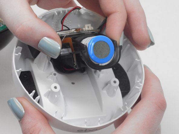

  11. Enabot EBO SE Speaker Replacement: crwdns2935265:011crwdnd2935265:01crwdnd2935265:02crwdne2935265:0 Enabot EBO SE Speaker Replacement: crwdns2935265:011crwdnd2935265:02crwdnd2935265:02crwdne2935265:0

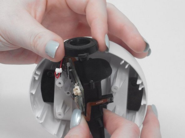

    • Pull the battery casing upwards from the lower half of the assembly to remove it.

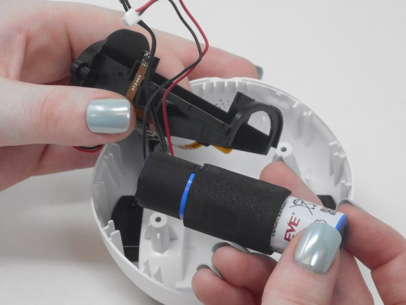

  12. Enabot EBO SE Speaker Replacement: crwdns2935265:012crwdnd2935265:01crwdnd2935265:02crwdne2935265:0 Enabot EBO SE Speaker Replacement: crwdns2935265:012crwdnd2935265:02crwdnd2935265:02crwdne2935265:0
    • Carefully remove the battery from the casing in order to replace.

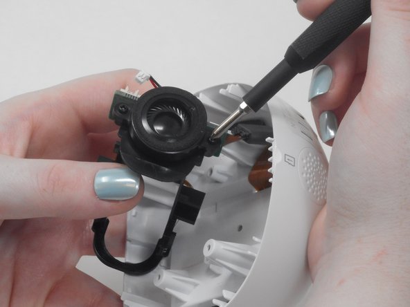

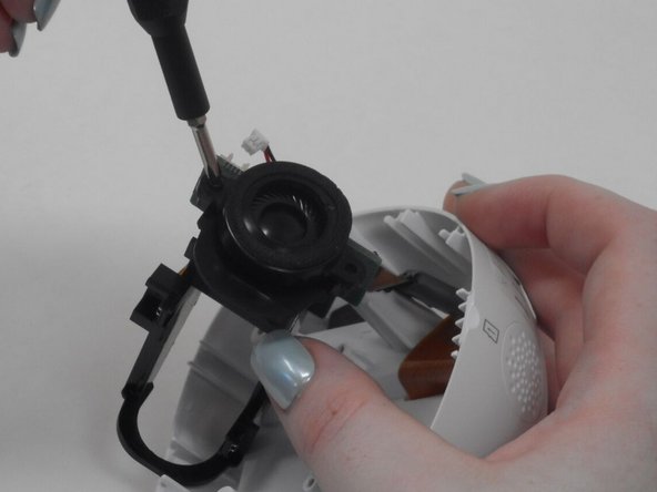

  13. Enabot EBO SE Speaker Replacement, Speaker: crwdns2935265:013crwdnd2935265:01crwdnd2935265:03crwdne2935265:0 Enabot EBO SE Speaker Replacement, Speaker: crwdns2935265:013crwdnd2935265:02crwdnd2935265:03crwdne2935265:0 Enabot EBO SE Speaker Replacement, Speaker: crwdns2935265:013crwdnd2935265:03crwdnd2935265:03crwdne2935265:0
    • Use a Phillips #00 screwdriver to remove each 7.4 mm screw from either side of the speaker.
    • Make sure to apply gentle force so it won't damage any other part of the Enabot EBO SE.

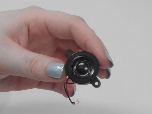

  14. Enabot EBO SE Speaker Replacement: crwdns2935265:014crwdnd2935265:01crwdnd2935265:03crwdne2935265:0 Enabot EBO SE Speaker Replacement: crwdns2935265:014crwdnd2935265:02crwdnd2935265:03crwdne2935265:0 Enabot EBO SE Speaker Replacement: crwdns2935265:014crwdnd2935265:03crwdnd2935265:03crwdne2935265:0
    • Remove the speaker from the battery casing.
