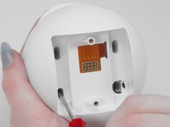

  2. Enabot EBO SE Motherboard Replacement: crwdns2935265:02crwdnd2935265:01crwdnd2935265:03crwdne2935265:0 Enabot EBO SE Motherboard Replacement: crwdns2935265:02crwdnd2935265:02crwdnd2935265:03crwdne2935265:0 Enabot EBO SE Motherboard Replacement: crwdns2935265:02crwdnd2935265:03crwdnd2935265:03crwdne2935265:0
    • Use a flathead 2.5 mm screwdriver to remove the 5.7 mm screw from the wheels.
    • A tool should have been provided in the box for this purpose.
  3. Enabot EBO SE Motherboard Replacement: crwdns2935265:03crwdnd2935265:01crwdnd2935265:02crwdne2935265:0 Enabot EBO SE Motherboard Replacement: crwdns2935265:03crwdnd2935265:02crwdnd2935265:02crwdne2935265:0
    • Pull the wheel assembly towards you so it comes straight off without resistance.
    • If there is resistance, make sure to apply gentle force when pulling as it can get damaged with too much force.
  4. Enabot EBO SE Motherboard Replacement, Lower Housing: crwdns2935265:04crwdnd2935265:01crwdnd2935265:02crwdne2935265:0 Enabot EBO SE Motherboard Replacement, Lower Housing: crwdns2935265:04crwdnd2935265:02crwdnd2935265:02crwdne2935265:0
    • Use a Torx screwdriver to remove the four 9 mm screws from the assembly.

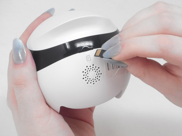

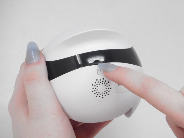

  5. Enabot EBO SE Motherboard Replacement: crwdns2935265:05crwdnd2935265:01crwdnd2935265:03crwdne2935265:0 Enabot EBO SE Motherboard Replacement: crwdns2935265:05crwdnd2935265:02crwdnd2935265:03crwdne2935265:0 Enabot EBO SE Motherboard Replacement: crwdns2935265:05crwdnd2935265:03crwdnd2935265:03crwdne2935265:0
    • Use your fingernail to carefully press down and eject the Micro SD Card from the back of the Enabot.
    • Keep the Micro SD Card in a safe spot for later.

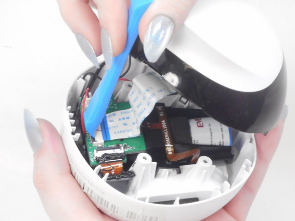

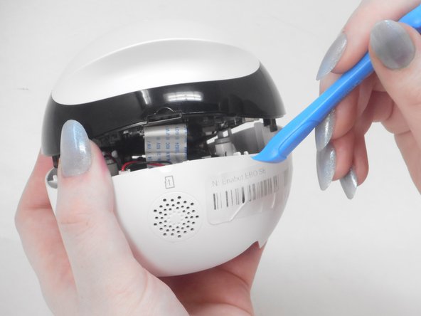

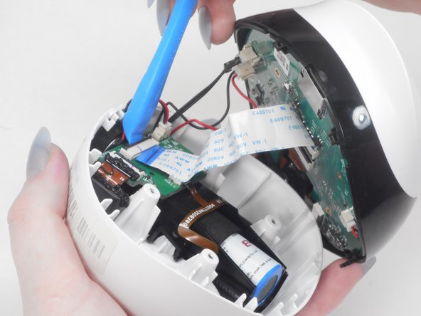

  6. Enabot EBO SE Motherboard Replacement: crwdns2935265:06crwdnd2935265:01crwdnd2935265:02crwdne2935265:0 Enabot EBO SE Motherboard Replacement: crwdns2935265:06crwdnd2935265:02crwdnd2935265:02crwdne2935265:0
    • Place the iFixit opening tool inside the Micro SD slot.
    • Very carefully apply pressure to the top of the slot and pry open the casing to separate the upper and lower housing.
  7. Enabot EBO SE Motherboard Replacement: crwdns2935265:07crwdnd2935265:01crwdnd2935265:03crwdne2935265:0 Enabot EBO SE Motherboard Replacement: crwdns2935265:07crwdnd2935265:02crwdnd2935265:03crwdne2935265:0 Enabot EBO SE Motherboard Replacement: crwdns2935265:07crwdnd2935265:03crwdnd2935265:03crwdne2935265:0
    • Using the iFixit opening tool or your fingernail, place it underneath the gray tab on the lower housing.
    • Lift the tab up and pull out the ribbon cable to disconnect it from the lower housing.

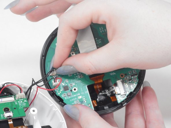

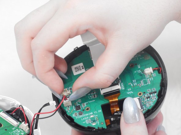

  8. Enabot EBO SE Motherboard Replacement: crwdns2935265:08crwdnd2935265:01crwdnd2935265:03crwdne2935265:0 Enabot EBO SE Motherboard Replacement: crwdns2935265:08crwdnd2935265:02crwdnd2935265:03crwdne2935265:0 Enabot EBO SE Motherboard Replacement: crwdns2935265:08crwdnd2935265:03crwdnd2935265:03crwdne2935265:0
    • There are two black and red wire connectors attached to the upper and lower housing.
    • Gently use your finger nails to lift up and disconnect both wires to fully separate the upper and lower housings.

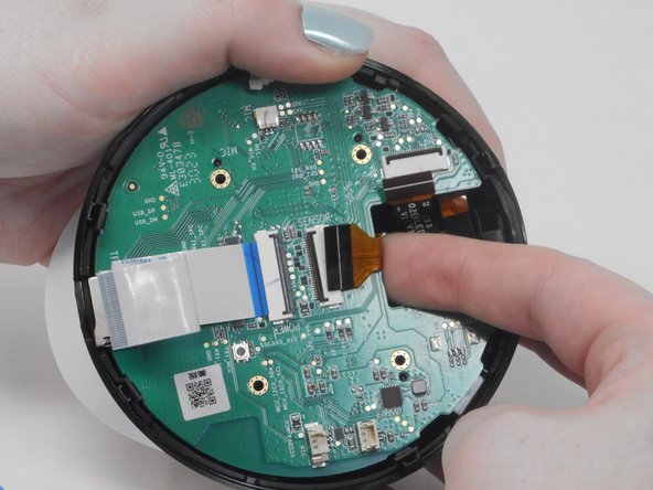

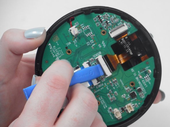

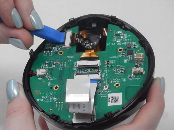

  9. Enabot EBO SE Motherboard Replacement, Motherboard: crwdns2935265:09crwdnd2935265:01crwdnd2935265:02crwdne2935265:0 Enabot EBO SE Motherboard Replacement, Motherboard: crwdns2935265:09crwdnd2935265:02crwdnd2935265:02crwdne2935265:0
    • Use the iFixit opening tool to unlock the side gray tab and free the orange & black ribbon cable.
  10. Enabot EBO SE Motherboard Replacement: crwdns2935265:010crwdnd2935265:01crwdnd2935265:02crwdne2935265:0 Enabot EBO SE Motherboard Replacement: crwdns2935265:010crwdnd2935265:02crwdnd2935265:02crwdne2935265:0
    • Use the iFixit opening tool to unlock the middle gray tab and free the orange & black ribbon cable.

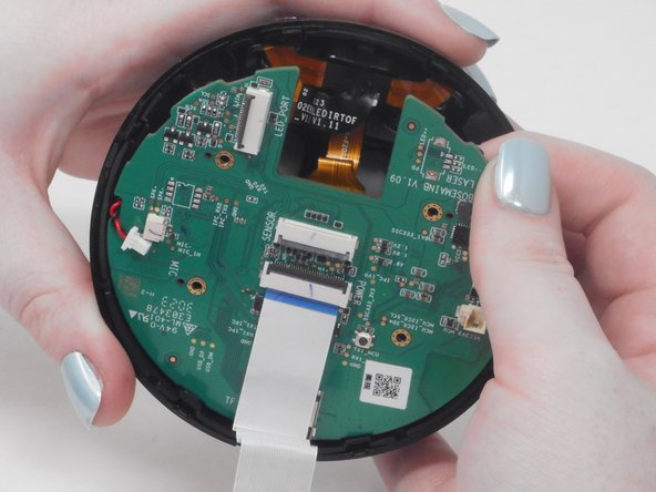

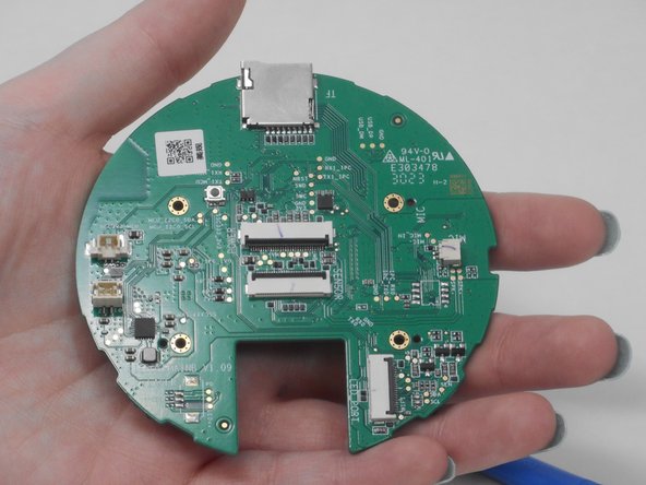

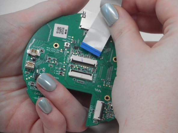

  11. Enabot EBO SE Motherboard Replacement: crwdns2935265:011crwdnd2935265:01crwdnd2935265:03crwdne2935265:0 Enabot EBO SE Motherboard Replacement: crwdns2935265:011crwdnd2935265:02crwdnd2935265:03crwdne2935265:0 Enabot EBO SE Motherboard Replacement: crwdns2935265:011crwdnd2935265:03crwdnd2935265:03crwdne2935265:0
    • Select one of the release tabs on the edge of the upper casing that holds the motherboard in place.
    • Place one finger in between the motherboard and the upper casing.
    • Pull the release tab back while lifting the motherboard with your other finger to "pop" the motherboard out of the casing.
  12. Enabot EBO SE Motherboard Replacement: crwdns2935265:012crwdnd2935265:01crwdnd2935265:03crwdne2935265:0 Enabot EBO SE Motherboard Replacement: crwdns2935265:012crwdnd2935265:02crwdnd2935265:03crwdne2935265:0 Enabot EBO SE Motherboard Replacement: crwdns2935265:012crwdnd2935265:03crwdnd2935265:03crwdne2935265:0
    • Use the ifixit opening tool to disconnect the blue & white ribbon cable.
    • Gently pull the blue & white ribbon cable out of the gray connector tab.
