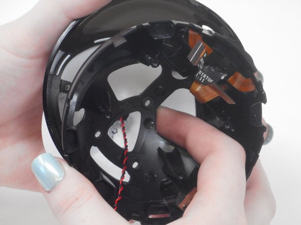

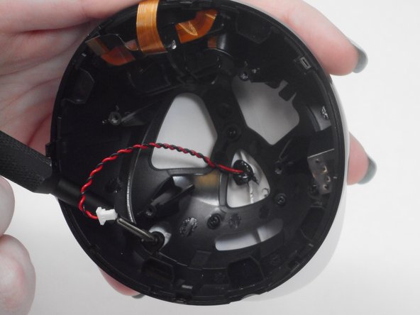

  8. Enabot EBO SE Camera Replacement: crwdns2935265:08crwdnd2935265:01crwdnd2935265:03crwdne2935265:0 Enabot EBO SE Camera Replacement: crwdns2935265:08crwdnd2935265:02crwdnd2935265:03crwdne2935265:0 Enabot EBO SE Camera Replacement: crwdns2935265:08crwdnd2935265:03crwdnd2935265:03crwdne2935265:0
    • There are two black and red wire connectors attached to the upper and lower housing.
    • Gently use your finger nails to lift up and disconnect both wires to fully separate the upper and lower housings.

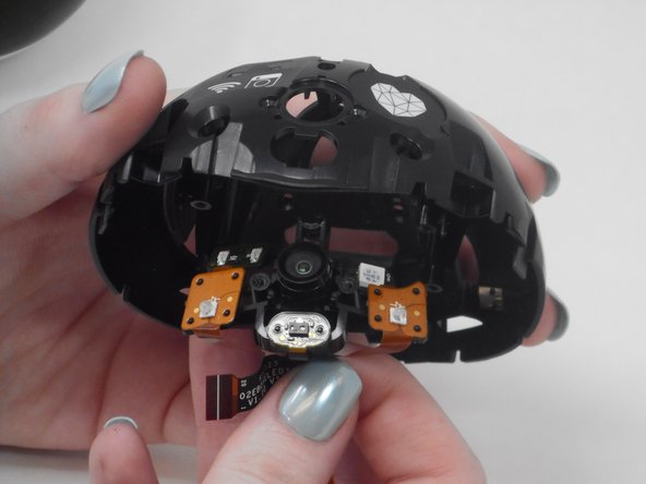

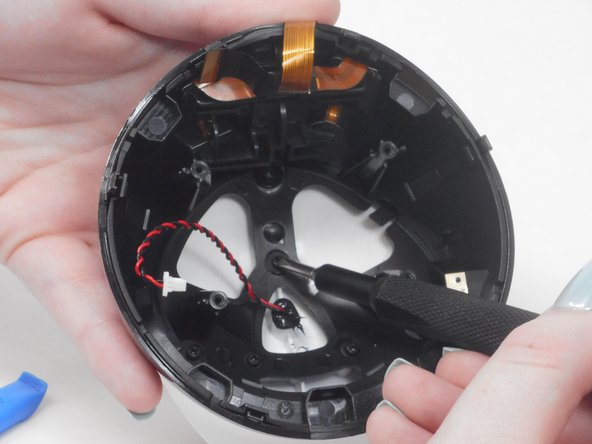

  13. Enabot EBO SE Camera Replacement, Camera: crwdns2935265:013crwdnd2935265:01crwdnd2935265:03crwdne2935265:0 Enabot EBO SE Camera Replacement, Camera: crwdns2935265:013crwdnd2935265:02crwdnd2935265:03crwdne2935265:0 Enabot EBO SE Camera Replacement, Camera: crwdns2935265:013crwdnd2935265:03crwdnd2935265:03crwdne2935265:0
    • Use a Phillips #00 screwdriver to remove all five 7.4 mm screws from the upper casing.
  14. Enabot EBO SE Camera Replacement: crwdns2935265:014crwdnd2935265:01crwdnd2935265:02crwdne2935265:0 Enabot EBO SE Camera Replacement: crwdns2935265:014crwdnd2935265:02crwdnd2935265:02crwdne2935265:0

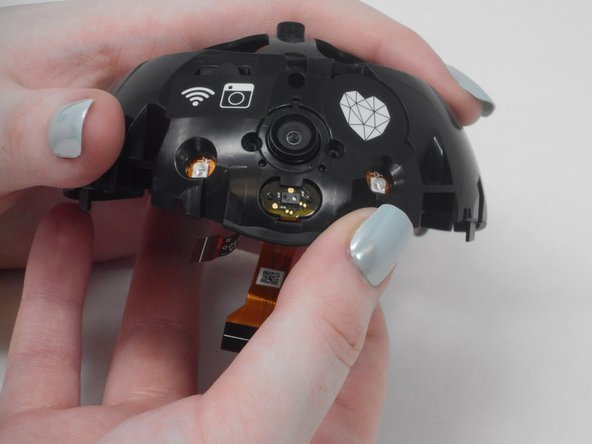

    • Place your fingers in the space between the black casing and white lid.
    • Pull black casing towards you to separate the two parts.

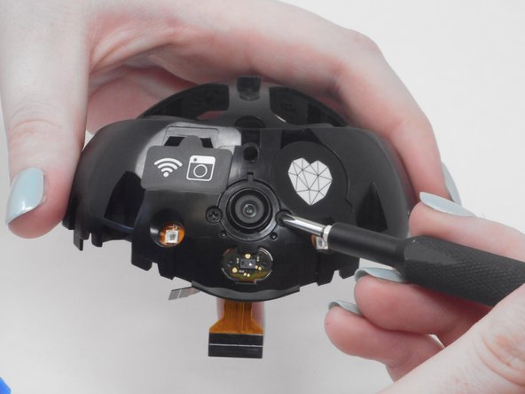

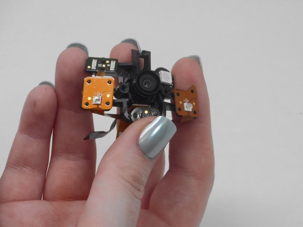

  15. Enabot EBO SE Camera Replacement: crwdns2935265:015crwdnd2935265:01crwdnd2935265:03crwdne2935265:0 Enabot EBO SE Camera Replacement: crwdns2935265:015crwdnd2935265:02crwdnd2935265:03crwdne2935265:0 Enabot EBO SE Camera Replacement: crwdns2935265:015crwdnd2935265:03crwdnd2935265:03crwdne2935265:0
    • Remove the two 6 mm Phillips #00 screws on either side of the camera.
  16. Enabot EBO SE Camera Replacement: crwdns2935265:016crwdnd2935265:01crwdnd2935265:03crwdne2935265:0 Enabot EBO SE Camera Replacement: crwdns2935265:016crwdnd2935265:02crwdnd2935265:03crwdne2935265:0 Enabot EBO SE Camera Replacement: crwdns2935265:016crwdnd2935265:03crwdnd2935265:03crwdne2935265:0
    • Gently remove the camera until it comes out of the casing.
