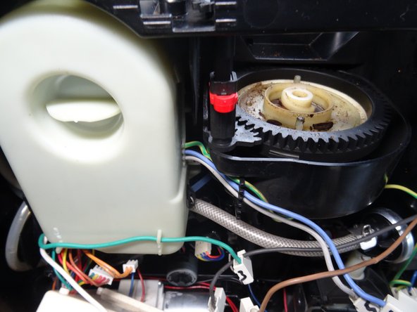

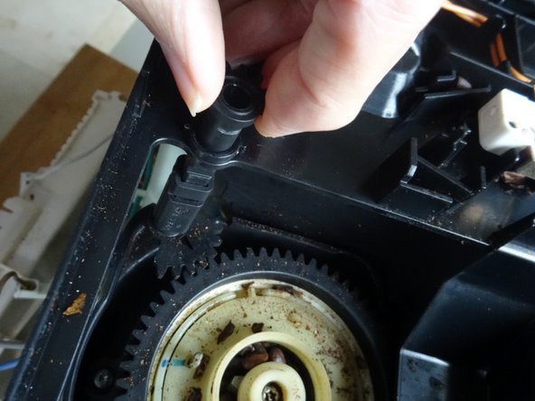

  14. Ena Micro 9 grindstone replacement, Grindstones: crwdns2935265:014crwdnd2935265:01crwdnd2935265:03crwdne2935265:0 Ena Micro 9 grindstone replacement, Grindstones: crwdns2935265:014crwdnd2935265:02crwdnd2935265:03crwdne2935265:0 Ena Micro 9 grindstone replacement, Grindstones: crwdns2935265:014crwdnd2935265:03crwdnd2935265:03crwdne2935265:0
    • The grinder is now open.
    • Pull off the red plastic clip on the grind adjuster.
    • Lift out the grinder adjuster.
    • When reassembling, make sure that the deflection lever for actuating the white microswitch is inserted correctly. (Already removed in the picture). The axle is marked in red.

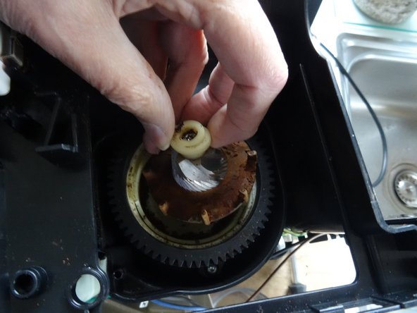

  15. Ena Micro 9 grindstone replacement: crwdns2935265:015crwdnd2935265:01crwdnd2935265:02crwdne2935265:0 Ena Micro 9 grindstone replacement: crwdns2935265:015crwdnd2935265:02crwdnd2935265:02crwdne2935265:0
    • Basically, the grindstones are replaced in the same way as with other Jura grinders, use these instructions.
    • Be sure to follow the instructions in the next step before you buy the grindstones!

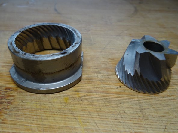

  16. Ena Micro 9 grindstone replacement: crwdns2935265:016crwdnd2935265:01crwdnd2935265:02crwdne2935265:0 Ena Micro 9 grindstone replacement: crwdns2935265:016crwdnd2935265:02crwdnd2935265:02crwdne2935265:0
    • Different grinders are used in the ENA models. The grindstones must be replaced with the same type. It is better to remove the grindstones beforehand and compare them before buying new ones.
    • The first picture shows the grindstones for the Aroma Plus grinder. An indication of this is that the grinding process only takes about 3 seconds. A groove is clearly visible on the upper edge of the grinding ring. The grinder has a slightly different design, the slip clutch with springs and balls under the grinding cone is missing.
    • The second picture shows the conventional model. The grinding ring has no groove. The grinding process takes about 6 seconds.
