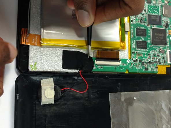

  3. Emerson EM744 Speaker Replacement, Speaker: crwdns2935265:03crwdnd2935265:01crwdnd2935265:03crwdne2935265:0 Emerson EM744 Speaker Replacement, Speaker: crwdns2935265:03crwdnd2935265:02crwdnd2935265:03crwdne2935265:0 Emerson EM744 Speaker Replacement, Speaker: crwdns2935265:03crwdnd2935265:03crwdnd2935265:03crwdne2935265:0
    • Using tweezers, carefully remove the tape covering the speaker.

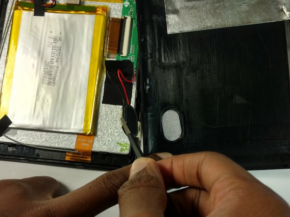

  4. Emerson EM744 Speaker Replacement: crwdns2935265:04crwdnd2935265:01crwdnd2935265:01crwdne2935265:0
    • Desolder the negative (black) wire from the negative (-) lead, followed by desoldering the positive (red) wire from the positive (+) lead.
    • Refer to the soldering technique guide.
