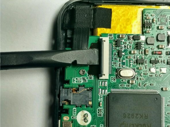

If the tablet has out of focus pictures or doesn't take them at all, this guide will show you how to replace the camera. Tools that are needed will include a Phillips Head screwdriver with a #00 3mm screw, spudger, plastic opening tool, as well as a pair of tweezers to properly remove the broken equipment.
    1. Emerson EM744 Camera Replacement, Back Plate: crwdns2935265:01crwdnd2935265:01crwdnd2935265:01crwdne2935265:0
      • Use a Phillips 00 bit to remove two 3mm screws from the bottom of the tablet.
    2. Emerson EM744 Camera Replacement: crwdns2935265:02crwdnd2935265:01crwdnd2935265:03crwdne2935265:0 Emerson EM744 Camera Replacement: crwdns2935265:02crwdnd2935265:02crwdnd2935265:03crwdne2935265:0 Emerson EM744 Camera Replacement: crwdns2935265:02crwdnd2935265:03crwdnd2935265:03crwdne2935265:0
      • Insert the nylon spudger into the bottom of the tablet, and gently slide it up the side.
      • Pull apart the two sides of the tablet, exposing the circuit board, battery, and other components of the tablet.
    1. Emerson EM744 Camera Replacement, Camera: crwdns2935265:03crwdnd2935265:01crwdnd2935265:02crwdne2935265:0 Emerson EM744 Camera Replacement, Camera: crwdns2935265:03crwdnd2935265:02crwdnd2935265:02crwdne2935265:0
      • Using the spudger to raise the zero insertion force (ZIF) connector to freely release the ribbon.
    2. Emerson EM744 Camera Replacement: crwdns2935265:04crwdnd2935265:01crwdnd2935265:01crwdne2935265:0
      • Using tweezers gently pull the ribbon off of the enclosure.
      • Remove the camera.
