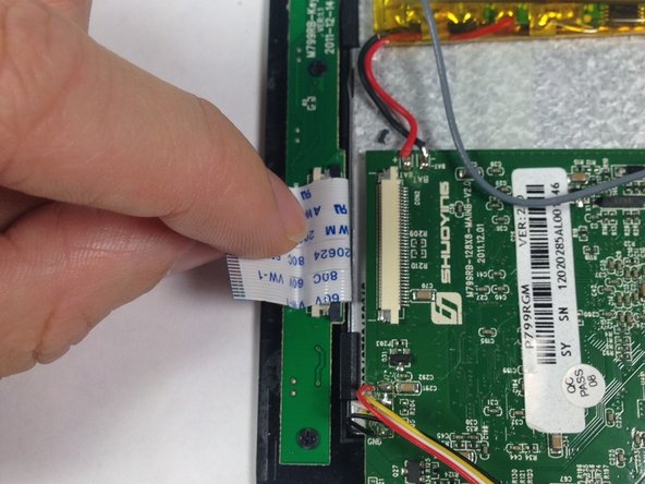

  7. Ematic eGlide 4 Screen Replacement, Motherboard: crwdns2935265:07crwdnd2935265:01crwdnd2935265:01crwdne2935265:0
    • Slide the grey ribbon wire connector clip away from the ribbon wire port on the motherboard using the pointed tip of a spudger.
    • You do not need to fully disconnect the ribbon wire clip from the ribbon wire port: the clip will stay attached in a loose fit.
    • Remove the gold ribbon wire from the ribbon wire port on the motherboard.

  9. Ematic eGlide 4 Screen Replacement: crwdns2935265:09crwdnd2935265:01crwdnd2935265:01crwdne2935265:0
    • Slide the grey ribbon wire connector clip away from the ribbon wire port using the pointed tip of a spudger.
    • Remove the ribbon wire from the ribbon wire port.
    • If you have already removed the side button array you do not need to do this step.

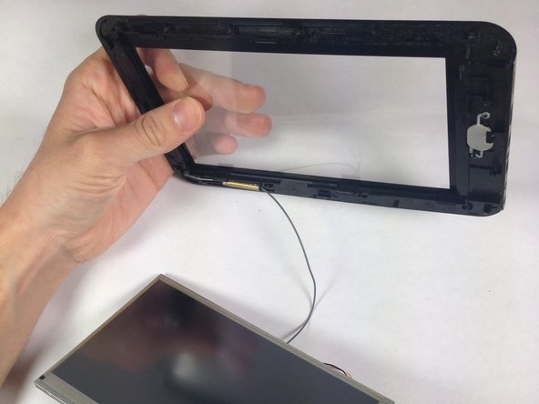

  14. Ematic eGlide 4 Screen Replacement, Screen: crwdns2935265:014crwdnd2935265:01crwdnd2935265:01crwdne2935265:0
    • Gently pull the front case clips down and off of the back of the screen
  15. Ematic eGlide 4 Screen Replacement: crwdns2935265:015crwdnd2935265:01crwdnd2935265:01crwdne2935265:0
    • Gently pull the front case clips down and off of the back of the screen for all of the remaining clips
  16. Ematic eGlide 4 Screen Replacement: crwdns2935265:016crwdnd2935265:01crwdnd2935265:02crwdne2935265:0 Ematic eGlide 4 Screen Replacement: crwdns2935265:016crwdnd2935265:02crwdnd2935265:02crwdne2935265:0
    • Gently pull the screen away from the front case
