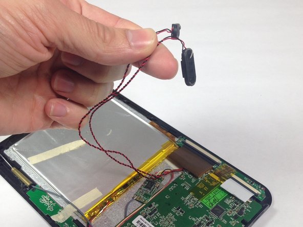

    • Carefully remove the speakers from the rear panel.
    • Pull the speakers off of the rear panel.
  4. Ematic eGlide 4 Motherboard Replacement, Speaker: crwdns2935265:04crwdnd2935265:01crwdnd2935265:01crwdne2935265:0

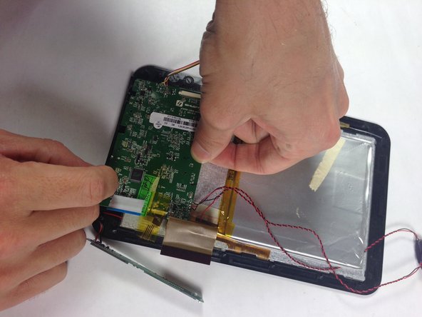

  5. Ematic eGlide 4 Motherboard Replacement, Motherboard: crwdns2935265:05crwdnd2935265:01crwdnd2935265:01crwdne2935265:0
    • Slide the grey ribbon wire connector clip away from the ribbon wire port on the motherboard using the pointed tip of a spudger.
    • You do not need to fully disconnect the ribbon wire clip from the ribbon wire port: the clip will stay attached in a loose fit.
    • Remove the gold ribbon wire from the ribbon wire port on the motherboard.
  6. Ematic eGlide 4 Motherboard Replacement: crwdns2935265:06crwdnd2935265:01crwdnd2935265:01crwdne2935265:0
    • Slide the grey ribbon wire connector clip away from the white ribbon wire port on the screen board using the pointed tip of a spudger.
    • Remove the ribbon wire from the ribbon wire port on the screen board.
  7. Ematic eGlide 4 Motherboard Replacement: crwdns2935265:07crwdnd2935265:01crwdnd2935265:01crwdne2935265:0
    • Slide the grey ribbon wire connector clip away from the ribbon wire port using the pointed tip of a spudger.
    • Remove the ribbon wire from the ribbon wire port.
    • If you have already removed the side button array you do not need to do this step.
  8. Ematic eGlide 4 Motherboard Replacement: crwdns2935265:08crwdnd2935265:01crwdnd2935265:01crwdne2935265:0
    • Remove the 2 Phillips #00 4.5 mm screws from the motherboard.
  9. Ematic eGlide 4 Motherboard Replacement: crwdns2935265:09crwdnd2935265:01crwdnd2935265:01crwdne2935265:0
    • Desolder the Wi-Fi Adaptor
    • If not replacing the motherboard or Wi-Fi Adaptor, omit this step
    • See ifixit's guide to soldering and desoldering for help: How to Solder and Desolder Connections
  10. Ematic eGlide 4 Motherboard Replacement: crwdns2935265:010crwdnd2935265:01crwdnd2935265:01crwdne2935265:0
    • Desolder the battery connections
    • If not replacing the motherboard or battery, omit this step
  11. Ematic eGlide 4 Motherboard Replacement: crwdns2935265:011crwdnd2935265:01crwdnd2935265:02crwdne2935265:0 Ematic eGlide 4 Motherboard Replacement: crwdns2935265:011crwdnd2935265:02crwdnd2935265:02crwdne2935265:0
    • Slide and pull the motherboard out of its current position, so that the ports disconnect from the device.
    • Lift the motherboard out of the device.
