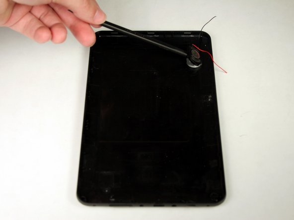

    • Unscrew the two (2) 1.3mm Phillips #00 screws found on the bottom edge of the tablet, where the power and volume buttons are located.
  2. Ematic Genesis Speaker Replacement: crwdns2935265:02crwdnd2935265:01crwdnd2935265:03crwdne2935265:0 Ematic Genesis Speaker Replacement: crwdns2935265:02crwdnd2935265:02crwdnd2935265:03crwdne2935265:0 Ematic Genesis Speaker Replacement: crwdns2935265:02crwdnd2935265:03crwdnd2935265:03crwdne2935265:0
    • Insert plastic opening tool into the edge between the screen plate and the back plate to create a separation between the casings.
    • Insert the flat end of the spudger next to the plastic opening tool and carefully pry the edges apart. Continue this all around the edges until the casings separate.
    • There may be cracking sounds when prying them apart. If carefully done, this is only the locks coming apart and is not harmful.
    • Be careful when separating the two plates as they are connected by the speaker wires and could be disconnected during this process.
  3. Ematic Genesis Speaker Replacement: crwdns2935265:03crwdnd2935265:01crwdnd2935265:01crwdne2935265:0
    • Remove back plate from screen plate and lay both down flat next to each other.
  4. Ematic Genesis Speaker Replacement, Speaker: crwdns2935265:04crwdnd2935265:01crwdnd2935265:01crwdne2935265:0
    • Once panels are separated, disconnect speaker wires from motherboard.
    • Make sure device is completely turned off before doing this to avoid a potential electric shock.
  5. Ematic Genesis Speaker Replacement: crwdns2935265:05crwdnd2935265:01crwdnd2935265:02crwdne2935265:0 Ematic Genesis Speaker Replacement: crwdns2935265:05crwdnd2935265:02crwdnd2935265:02crwdne2935265:0
    • Insert the flat end of the spudger between the casing and the speaker. Push inwards to pry the speaker from the casing.
