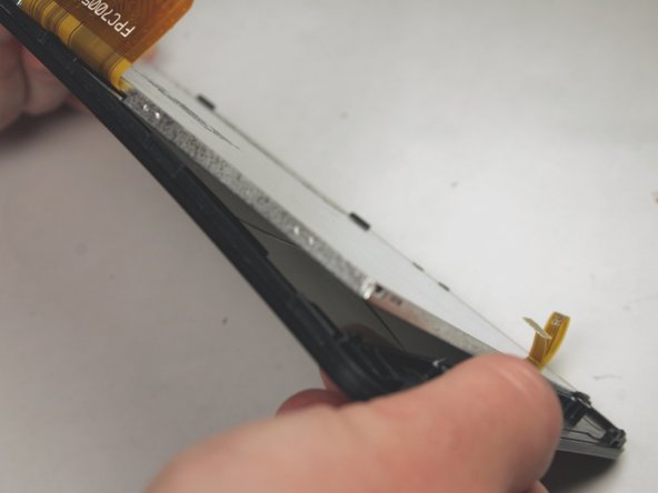

    1. Ematic Genesis Screen Replacement, Screen: crwdns2935265:015crwdnd2935265:01crwdnd2935265:02crwdne2935265:0 Ematic Genesis Screen Replacement, Screen: crwdns2935265:015crwdnd2935265:02crwdnd2935265:02crwdne2935265:0
      • Once the battery and motherboard have been removed, gently bend the screen plate to pop out the metal digitizer that sits on the glass and plastic screen.
      • Be careful when bending as glass could break.
