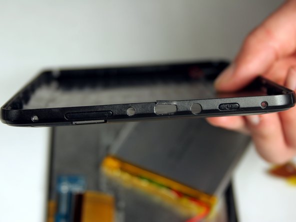

      • Unscrew the two (2) 1.3mm Phillips #00 screws found on the bottom edge of the tablet, where the power and volume buttons are located.
    2. Ematic Genesis Button Replacement: crwdns2935265:02crwdnd2935265:01crwdnd2935265:03crwdne2935265:0 Ematic Genesis Button Replacement: crwdns2935265:02crwdnd2935265:02crwdnd2935265:03crwdne2935265:0 Ematic Genesis Button Replacement: crwdns2935265:02crwdnd2935265:03crwdnd2935265:03crwdne2935265:0
      • Insert plastic opening tool into the edge between the screen plate and the back plate to create a separation between the casings.
      • Insert the flat end of the spudger next to the plastic opening tool and carefully pry the edges apart. Continue this all around the edges until the casings separate.
      • There may be cracking sounds when prying them apart. If carefully done, this is only the locks coming apart and is not harmful.
      • Be careful when separating the two plates as they are connected by the speaker wires and could be disconnected during this process.

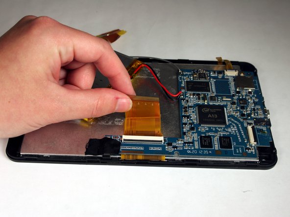

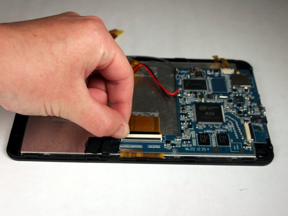

    1. Ematic Genesis Button Replacement, Button: crwdns2935265:010crwdnd2935265:01crwdnd2935265:03crwdne2935265:0 Ematic Genesis Button Replacement, Button: crwdns2935265:010crwdnd2935265:02crwdnd2935265:03crwdne2935265:0 Ematic Genesis Button Replacement, Button: crwdns2935265:010crwdnd2935265:03crwdnd2935265:03crwdne2935265:0
      • Once battery is removed, flip up the black lever of the connector that is holding the wide ribbon in place for the screen. Remove the ribbon from the connector.

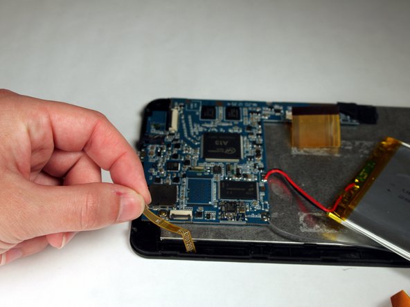

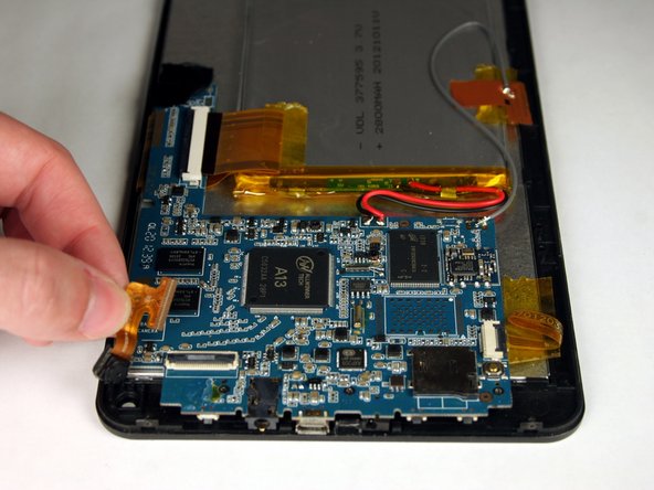

    2. Ematic Genesis Button Replacement: crwdns2935265:011crwdnd2935265:01crwdnd2935265:03crwdne2935265:0 Ematic Genesis Button Replacement: crwdns2935265:011crwdnd2935265:02crwdnd2935265:03crwdne2935265:0 Ematic Genesis Button Replacement: crwdns2935265:011crwdnd2935265:03crwdnd2935265:03crwdne2935265:0
      • Rotate the tablet 180 degrees and flip up the black lever of the connector holding the small, yellow ribbon. Remove ribbon from the connector.

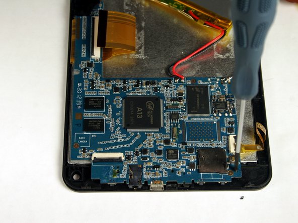

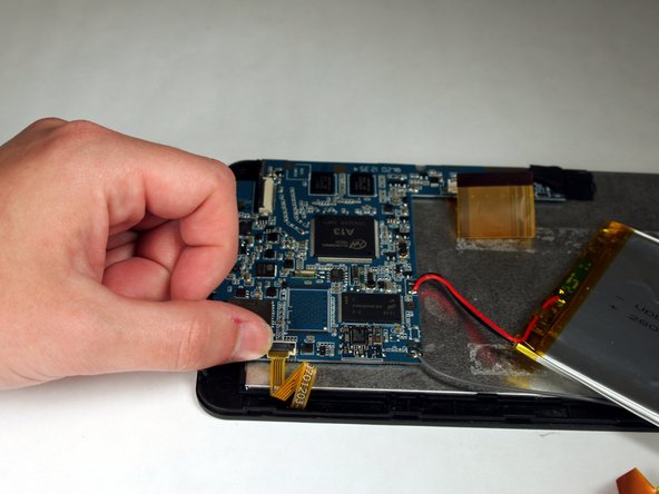

    3. Ematic Genesis Button Replacement: crwdns2935265:012crwdnd2935265:01crwdnd2935265:03crwdne2935265:0 Ematic Genesis Button Replacement: crwdns2935265:012crwdnd2935265:02crwdnd2935265:03crwdne2935265:0 Ematic Genesis Button Replacement: crwdns2935265:012crwdnd2935265:03crwdnd2935265:03crwdne2935265:0
      • Rotate the tablet 90 degrees and remove the three (3) 1.3 mm Phillips #00 screws that hold the motherboard in place.

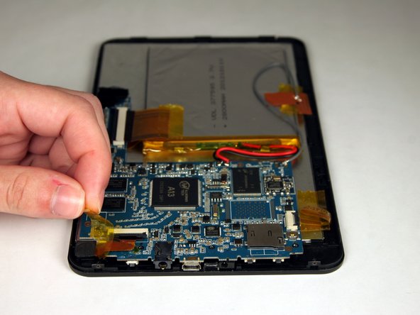

    4. Ematic Genesis Button Replacement: crwdns2935265:013crwdnd2935265:01crwdnd2935265:02crwdne2935265:0 Ematic Genesis Button Replacement: crwdns2935265:013crwdnd2935265:02crwdnd2935265:02crwdne2935265:0
      • Lift up the tape that covers the speaker wires and holds the motherboard in place.
      • This picture does not show speaker wires attached. These do NOT have to be disconnected for this.
      • Be careful not to disconnect the speaker wires from the motherboard. Otherwise, they will need to be soldered back on.

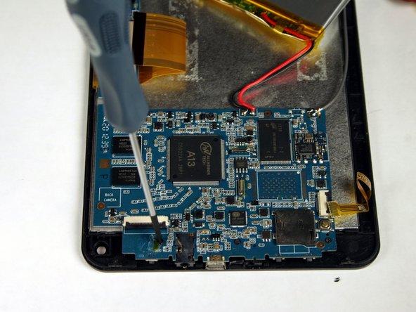

    5. Ematic Genesis Button Replacement: crwdns2935265:014crwdnd2935265:01crwdnd2935265:02crwdne2935265:0 Ematic Genesis Button Replacement: crwdns2935265:014crwdnd2935265:02crwdnd2935265:02crwdne2935265:0
      • With the motherboard detached from the screen plate, there is now access to the electrical components under the motherboard and the mechanical button components on the back plate.
