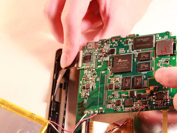

  3. Ematic Genesis 2 Screen Replacement: crwdns2935265:03crwdnd2935265:01crwdnd2935265:02crwdne2935265:0 Ematic Genesis 2 Screen Replacement: crwdns2935265:03crwdnd2935265:02crwdnd2935265:02crwdne2935265:0
    • Remove the three screws surrounding the circuit board using the Phillips Head Screwdriver.
    • Remove the circuit board from the device by uncliping the copper flexible PCB ribbon cable from the circuit board.
