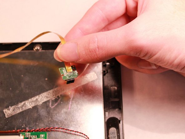

    • Remove both screws on either side of the audio jack using the Philips head screwdriver.
    • Detach audio jack from device.

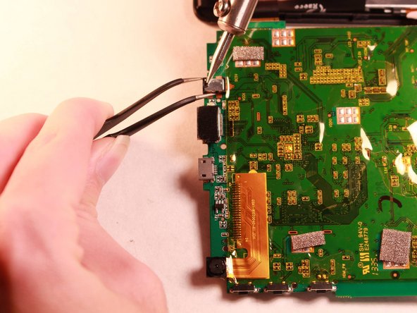

    • Use a soldering iron to heat the solder holding the charging port to the circuit board.
    • Remove the charging port from board using tweezers.
  6. Ematic Genesis 2 Charging Port Replacement: crwdns2935265:06crwdnd2935265:01crwdnd2935265:01crwdne2935265:0
    • Solder replacement port into place.
    • Make sure all connections match original.
