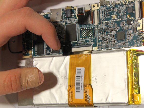

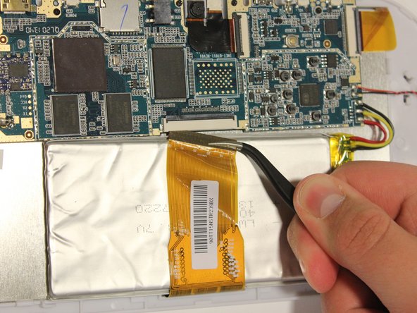

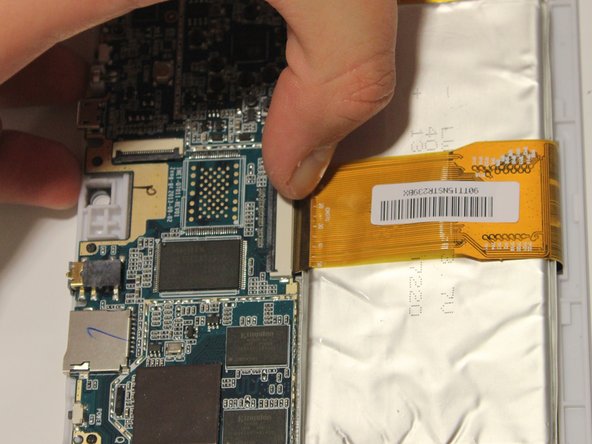

  3. Ematic FunTab 2 Motherboard Replacement: crwdns2935265:03crwdnd2935265:01crwdnd2935265:03crwdne2935265:0 Ematic FunTab 2 Motherboard Replacement: crwdns2935265:03crwdnd2935265:02crwdnd2935265:03crwdne2935265:0 Ematic FunTab 2 Motherboard Replacement: crwdns2935265:03crwdnd2935265:03crwdnd2935265:03crwdne2935265:0
    • Remove LCD connector from the LCD.
    • Be sure to flip up the retaining tabs before pulling the LCD connector out. (It is the black tab on the connection port).

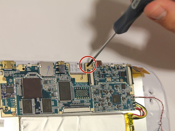

  4. Ematic FunTab 2 Motherboard Replacement: crwdns2935265:04crwdnd2935265:01crwdnd2935265:01crwdne2935265:0
    • Remove camera connection from camera with tweezers.
    • Again, be sure to flip up the retaining tab before pulling the connector.

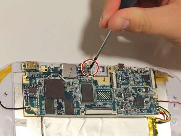

  5. Ematic FunTab 2 Motherboard Replacement: crwdns2935265:05crwdnd2935265:01crwdnd2935265:01crwdne2935265:0
    • Remove speaker connection from speaker with tweezers.
    • Before pulling the speaker connection make sure the retaining tab is flipped up.

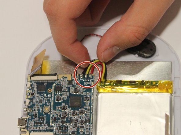

  6. Ematic FunTab 2 Motherboard Replacement: crwdns2935265:06crwdnd2935265:01crwdnd2935265:03crwdne2935265:0 Ematic FunTab 2 Motherboard Replacement: crwdns2935265:06crwdnd2935265:02crwdnd2935265:03crwdne2935265:0 Ematic FunTab 2 Motherboard Replacement: crwdns2935265:06crwdnd2935265:03crwdnd2935265:03crwdne2935265:0

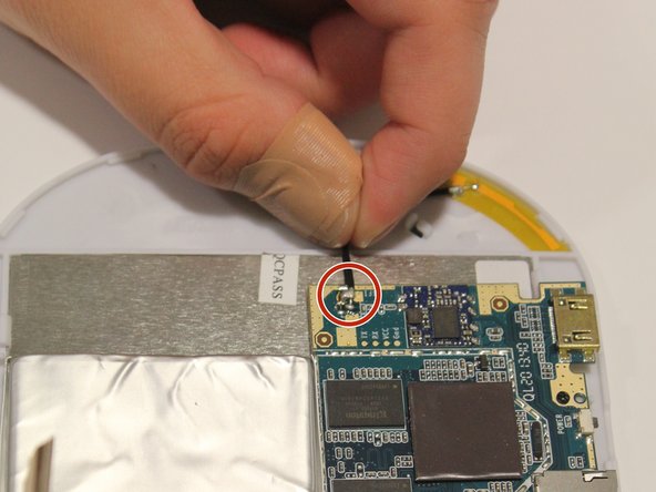

    • Remove wires:
    • Start by removing the black wire on each side.
    • Next, remove the WiFi antenna wire from the motherboard.
    • Finally, remove the yellow, red, and black wires.
    • To put the wires back in their correct locations you will need a soldering iron to solder the wire back in place. You will do this once the motherboard is replaced. Here is a guide on how to solder How To Solder and Desolder Connections
