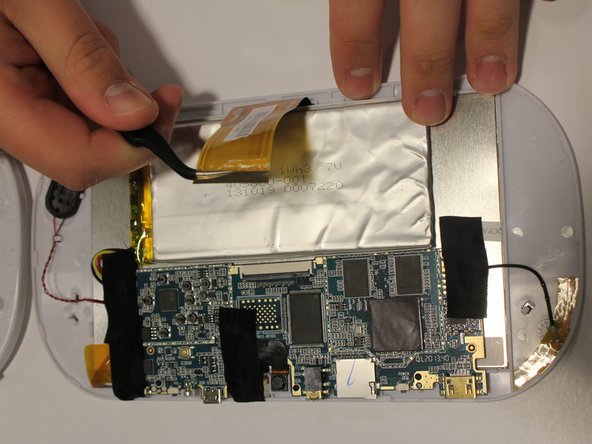

    • Remove tape from the LCD connector.
  3. Ematic FunTab 2 Battery Replacement: crwdns2935265:03crwdnd2935265:01crwdnd2935265:02crwdne2935265:0 Ematic FunTab 2 Battery Replacement: crwdns2935265:03crwdnd2935265:02crwdnd2935265:02crwdne2935265:0
    • Flip up the retaining tab (the black bar on the connector), then pull LCD connector with tweezers. Be careful not to damage the LCD connector.

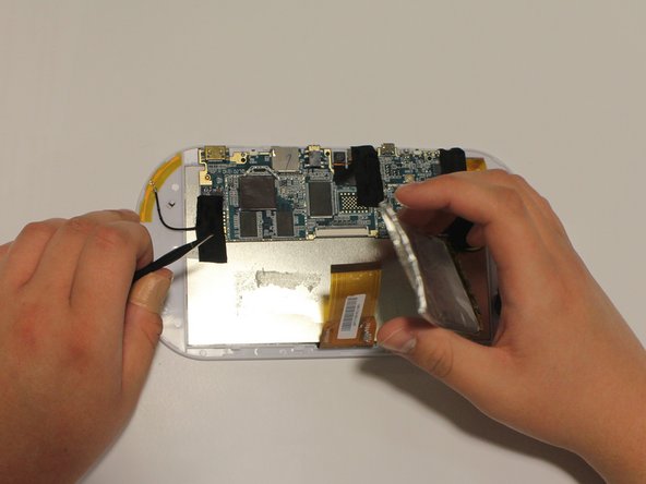

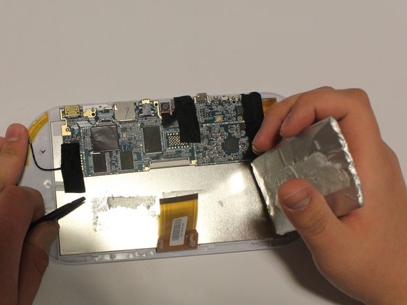

  4. Ematic FunTab 2 Battery Replacement: crwdns2935265:04crwdnd2935265:01crwdnd2935265:03crwdne2935265:0 Ematic FunTab 2 Battery Replacement: crwdns2935265:04crwdnd2935265:02crwdnd2935265:03crwdne2935265:0 Ematic FunTab 2 Battery Replacement: crwdns2935265:04crwdnd2935265:03crwdnd2935265:03crwdne2935265:0
    • Now remove battery by putting the spudger between the battery and the LCD display and prying apart.
    • Be careful when prying the battery from the display. Wiggle the spudger if necessary.

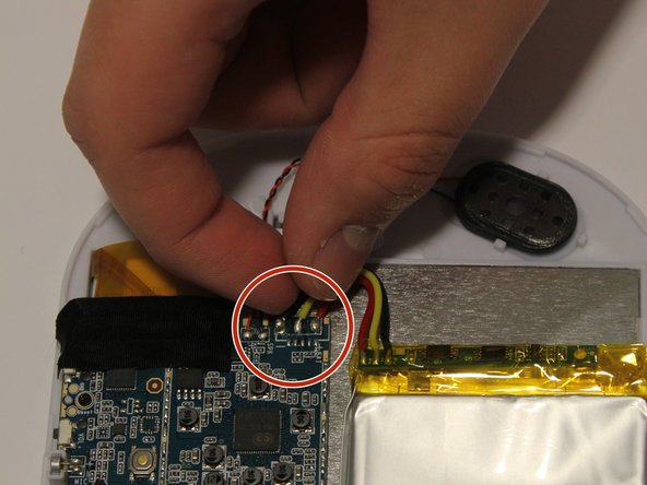

  5. Ematic FunTab 2 Battery Replacement: crwdns2935265:05crwdnd2935265:01crwdnd2935265:01crwdne2935265:0
    • Remove tape from the yellow, red, and black wires connecting the battery to the LCD.

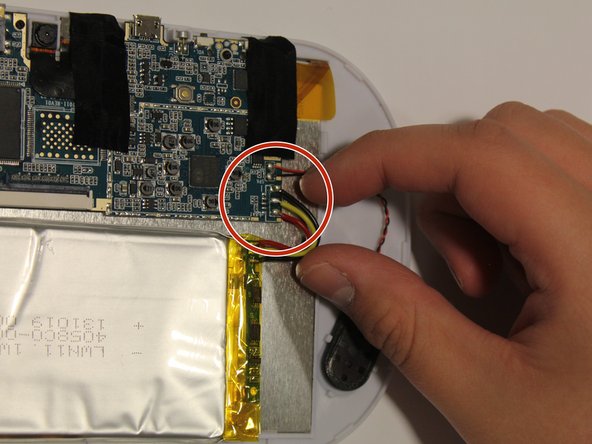

  6. Ematic FunTab 2 Battery Replacement: crwdns2935265:06crwdnd2935265:01crwdnd2935265:03crwdne2935265:0 Ematic FunTab 2 Battery Replacement: crwdns2935265:06crwdnd2935265:02crwdnd2935265:03crwdne2935265:0 Ematic FunTab 2 Battery Replacement: crwdns2935265:06crwdnd2935265:03crwdnd2935265:03crwdne2935265:0
    • Disconnect the yellow, red, and black wires from the motherboard.
    • You will need to solder these wires back after completing the battery replacement. Here is a link on how to solder How To Solder and Desolder Connections.
  7. Ematic FunTab 2 Battery Replacement: crwdns2935265:07crwdnd2935265:01crwdnd2935265:01crwdne2935265:0
    • Now remove battery. The battery should still be pried from the LCD display, if not pry it again.
