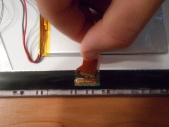

  9. Ematic Exp8 Battery Replacement: crwdns2935265:09crwdnd2935265:01crwdnd2935265:01crwdne2935265:0
    • Re-connect yellow cable over the top of the battery to it's insertion point.
