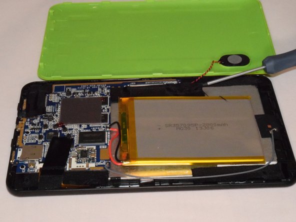

    • There are two screws on the side with the micro USB power port. Remove the two 2mm x 0.5mm screws with a Phillips #0 Screwdriver head.
  2. Ematic EGQ307 Speaker Replacement: crwdns2935265:02crwdnd2935265:01crwdnd2935265:02crwdne2935265:0 Ematic EGQ307 Speaker Replacement: crwdns2935265:02crwdnd2935265:02crwdnd2935265:02crwdne2935265:0

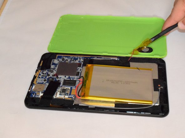

    • Pry off the plastic backing with the spudger and the plastic opening tools. Anything that can provide enough leverage and not conduct electricity will also work for this purpose.
    • Carefully separate the front and back plates because the wire that connects the speaker is connected to both the front and back plates.

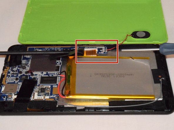

    • Once you pry off the plastic backing, you will expose the battery and the motherboard. Then remove the tape on the speaker wire.

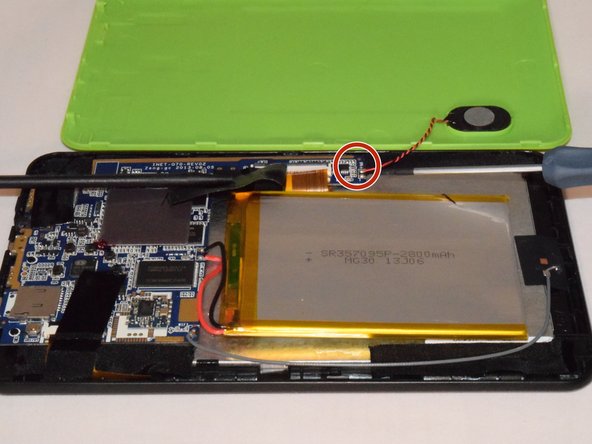

    • Carefully remove tapes holding speaker in place.
    • Disconnect the speaker wires from the motherboard.
    • When working with device, make sure the battery is dead and there is not plugged in to the charger to limit the risk of shock.
