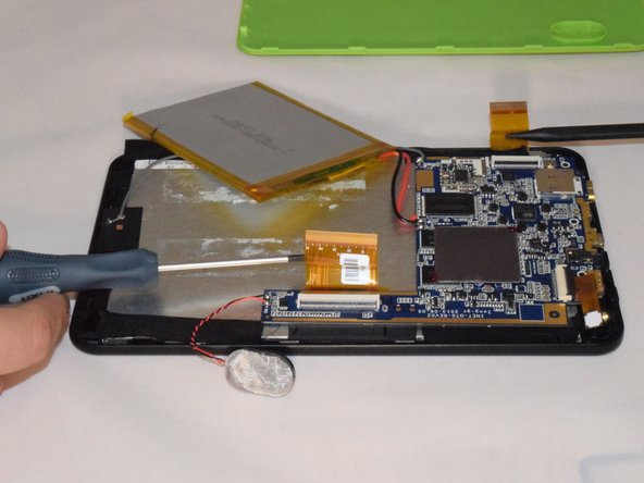

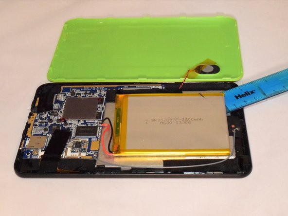

      • Once you pry off the plastic backing, you will expose the battery and the motherboard.
      • Remove the tape holding the battery to the plastic frame. The battery is glued to the back of the LCD.
      • Pry the battery off the LCD using a flat and rigid piece of plastic, such as the plastic card.

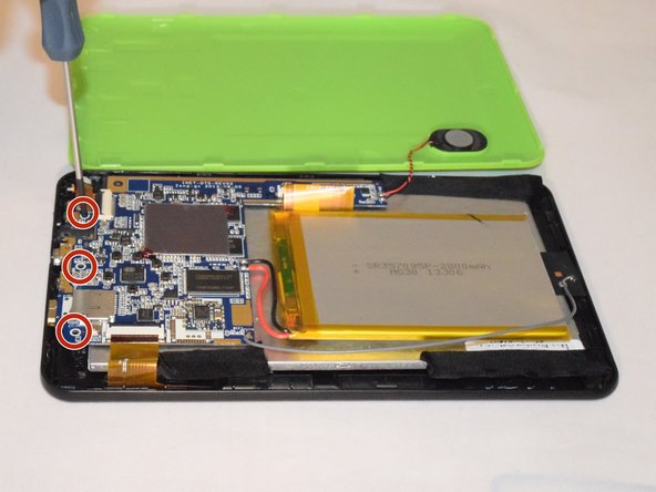

      • Remove the three 2mm x 0.5mm screws with a Phillips #0 Screwdriver head from the motherboard.

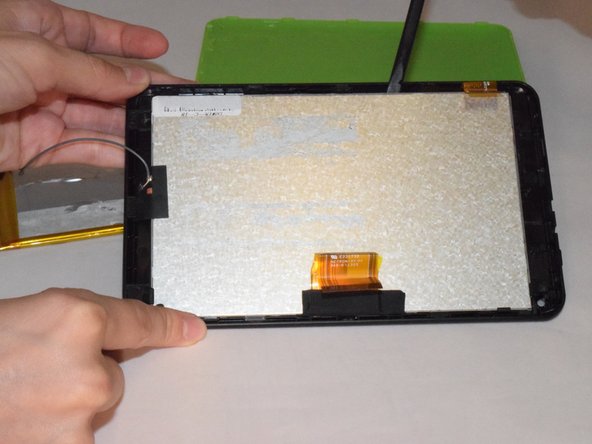

      • Carefully remove the motherboard from the LCD backing. Remove tape from the edges of the LCD.
      • Carefully pry off the LCD with the spudger.
      • Carefully remove the motherboard, battery, and the speaker, so wires do not get disconnected.

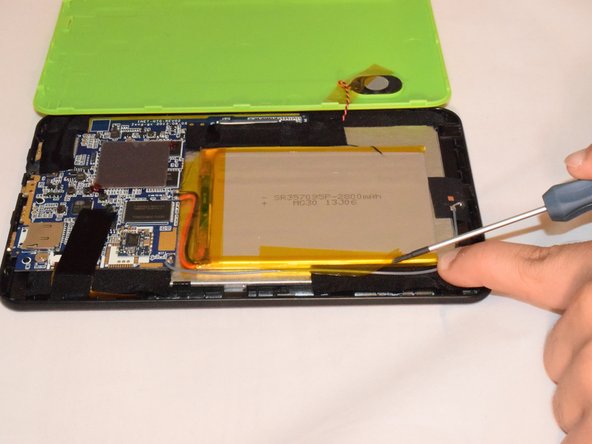

    5. Ematic EGQ307 LCD Replacement: crwdns2935265:05crwdnd2935265:01crwdnd2935265:03crwdne2935265:0 Ematic EGQ307 LCD Replacement: crwdns2935265:05crwdnd2935265:02crwdnd2935265:03crwdne2935265:0 Ematic EGQ307 LCD Replacement: crwdns2935265:05crwdnd2935265:03crwdnd2935265:03crwdne2935265:0

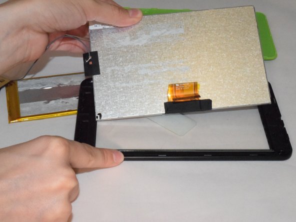

      • Now LCD is removed and is ready to be replaced.
To reassemble your device, follow these instructions in reverse order, note you will need to solder for this replacement.
