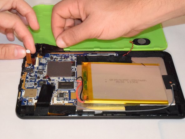

      • Pry off the plastic backing with the spudger and the plastic opening tools. Anything that can provide enough leverage and not conduct electricity will also work for this purpose.
      • Carefully separate the front and back plates because the wire that connects the speaker is connected to both the front and back plates.
    3. Ematic EGQ307 Front Facing Camera Replacement: crwdns2935265:03crwdnd2935265:01crwdnd2935265:01crwdne2935265:0
      • Once you pry off the plastic backing, you will expose the battery and the motherboard.

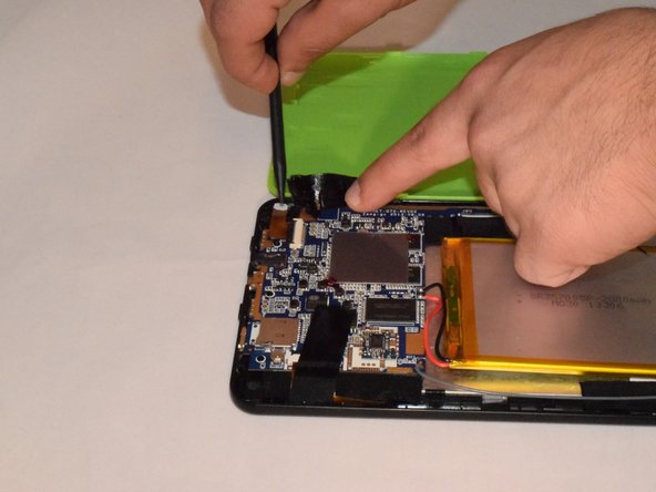

      • carefully pry off the plastic backing, remove the tape over the camera.
      • When working with device, make sure the battery is dead and there is not plugged in to the charger to limit the risk of shock.
    5. Ematic EGQ307 Front Facing Camera Replacement: crwdns2935265:05crwdnd2935265:01crwdnd2935265:02crwdne2935265:0 Ematic EGQ307 Front Facing Camera Replacement: crwdns2935265:05crwdnd2935265:02crwdnd2935265:02crwdne2935265:0
      • Carefully remove the tape holding the camera in place as the camera is attached to the backing of the tape.
      • Gently lift up the black lever that’s holding the camera ribbon in place using the spudger tools.
      • Once lever is lifted up, remove camera from device; and it is ready to be replaced.
