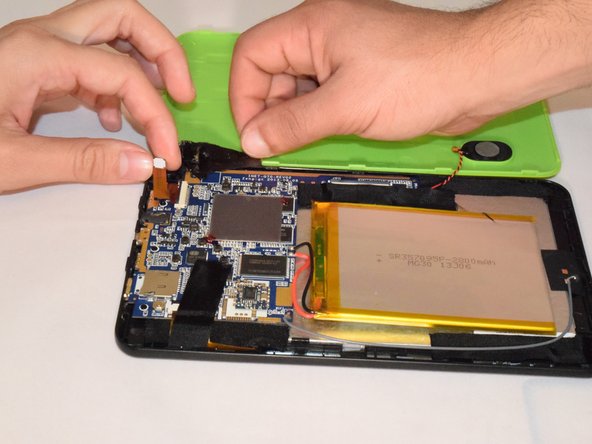

    • Pry off the plastic backing with the spudger and the plastic opening tools. Anything that can provide enough leverage and not conduct electricity will also work for this purpose.
    • Carefully separate the front and back plates because the wire that connects the speaker is connected to both the front and back plates.

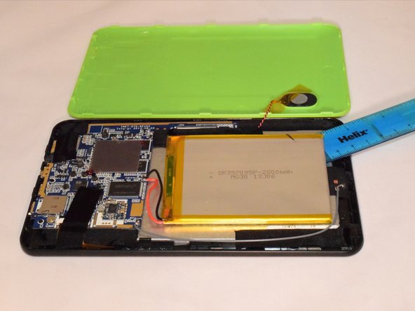

  3. Ematic EGQ307 Digitizer Replacement: crwdns2935265:03crwdnd2935265:01crwdnd2935265:03crwdne2935265:0 Ematic EGQ307 Digitizer Replacement: crwdns2935265:03crwdnd2935265:02crwdnd2935265:03crwdne2935265:0 Ematic EGQ307 Digitizer Replacement: crwdns2935265:03crwdnd2935265:03crwdnd2935265:03crwdne2935265:0
    Plastic Cards
    $2.99

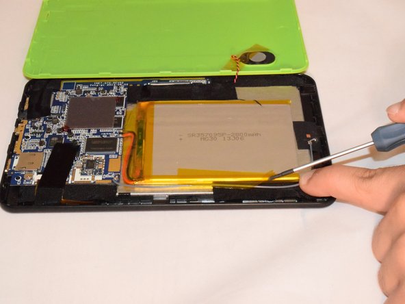

    • Once you pry off the plastic backing, you will expose the battery and the motherboard.
    • Remove the tape holding the battery to the plastic frame. The battery is glued to the back of the LCD.
    • Pry the battery off the LCD using a flat and rigid piece of plastic, such as the plastic card.

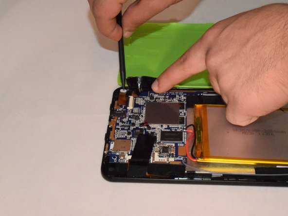

    • Carefully remove the tape holding the camera in place as the camera is attached to the backing of the tape.
    • Gently lift up the black lever that’s holding the camera ribbon in place using a long piece of stiff plastic.
    • Now, remove the camera from the device.

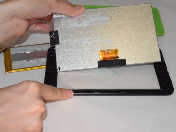

  5. Ematic EGQ307 Digitizer Replacement: crwdns2935265:05crwdnd2935265:01crwdnd2935265:03crwdne2935265:0 Ematic EGQ307 Digitizer Replacement: crwdns2935265:05crwdnd2935265:02crwdnd2935265:03crwdne2935265:0 Ematic EGQ307 Digitizer Replacement: crwdns2935265:05crwdnd2935265:03crwdnd2935265:03crwdne2935265:0

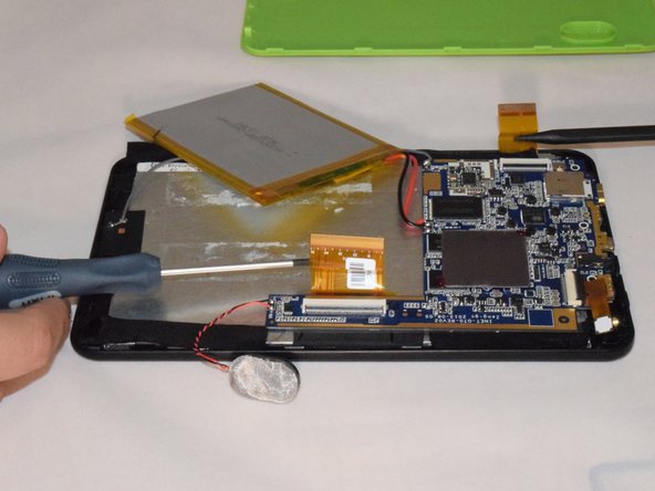

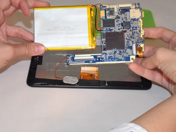

    • Remove the three 2mm x 0.5mm screws with a Phillips #0 Screwdriver head from the motherboard.
    • Carefully remove the motherboard from the LCD backing. Remove tape from the edges of the LCD.
    • Carefully pry off the LCD with a piece of plastic.
    • Carefully remove the motherboard, battery, and the speaker, so wires do not get disconnected.
  6. Ematic EGQ307 Digitizer Replacement: crwdns2935265:06crwdnd2935265:01crwdnd2935265:03crwdne2935265:0 Ematic EGQ307 Digitizer Replacement: crwdns2935265:06crwdnd2935265:02crwdnd2935265:03crwdne2935265:0 Ematic EGQ307 Digitizer Replacement: crwdns2935265:06crwdnd2935265:03crwdnd2935265:03crwdne2935265:0

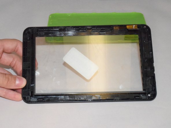

    • Now Protective Screen is removed and is ready to be replaced.
