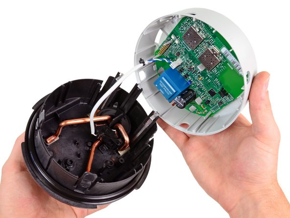

  4. Elster REX2 Smart Meter Teardown: crwdns2935265:04crwdnd2935265:01crwdnd2935265:02crwdne2935265:0 Elster REX2 Smart Meter Teardown: crwdns2935265:04crwdnd2935265:02crwdnd2935265:02crwdne2935265:0
    • The two halves of the case are held together with four plastic clips.
    • Once all the clips are depressed, the two halves "pop" apart making access to the internals easier.
    • Separating the two halves provides the first glimpse of the meter's surprising deficiency of internal components.

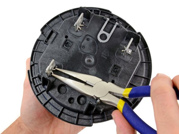

  5. Elster REX2 Smart Meter Teardown: crwdns2935265:05crwdnd2935265:01crwdnd2935265:03crwdne2935265:0 Elster REX2 Smart Meter Teardown: crwdns2935265:05crwdnd2935265:02crwdnd2935265:03crwdne2935265:0 Elster REX2 Smart Meter Teardown: crwdns2935265:05crwdnd2935265:03crwdnd2935265:03crwdne2935265:0
    Large Needle Nose Pliers
    • After disconnecting a single cable, we get a good look at the smart meter's power connections.
    • The retaining clips holding the power connections to the back of the rear case are easily removed using our large needle-nose pliers.
    • After a bit of wiggling, the power connections come out with little resistance.

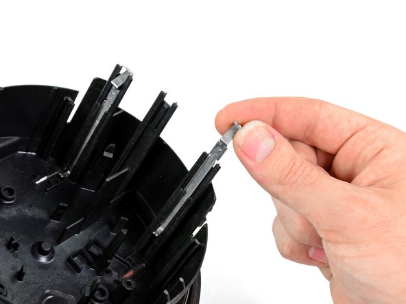

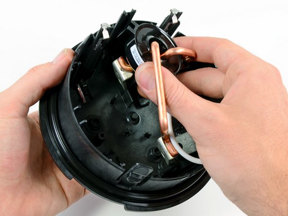

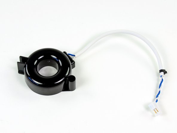

  6. Elster REX2 Smart Meter Teardown: crwdns2935265:06crwdnd2935265:01crwdnd2935265:03crwdne2935265:0 Elster REX2 Smart Meter Teardown: crwdns2935265:06crwdnd2935265:02crwdnd2935265:03crwdne2935265:0 Elster REX2 Smart Meter Teardown: crwdns2935265:06crwdnd2935265:03crwdnd2935265:03crwdne2935265:0
    • Extremely thick copper wires allow the meter to be wired in series with a household's main power supply. They're capable of handling 200 Amps!
    • Interestingly, the meter relies on a black ring-shaped current transformer installed around the copper wires to send power consumption signals to the main board.
    • Current transformers indirectly measure the current flowing through the thick copper conductors and provide an output that can be read by the electronics on the board.
    • Long metal pressure contacts along the inside case of the meter conduct 240V AC electricity to pads that provide power to the main board.

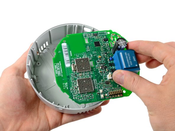

  7. Elster REX2 Smart Meter Teardown: crwdns2935265:07crwdnd2935265:01crwdnd2935265:02crwdne2935265:0 Elster REX2 Smart Meter Teardown: crwdns2935265:07crwdnd2935265:02crwdnd2935265:02crwdne2935265:0
    • Well what have we here? Can this be true? In the whole device there is only one screw, a surprisingly difficult to find Phillips #1.
    • After pushing a few clips aside, the motherboard is easily removed from the front case.
  8. Elster REX2 Smart Meter Teardown: crwdns2935265:08crwdnd2935265:01crwdnd2935265:01crwdne2935265:0
    • Main IC's located on the front side of the motherboard include:
    • Teridian 71M6531F SoC with an MPU core, RTC, FLASH and LCD driver
    • Texas Instruments LM2904 low power dual operational amplifier
    • RMFD RF2172 medium-power high efficiency amplifier IC
    • Texas Instruments CC1110F32 Sub-1GHz System-on-Chip with MCU and 32kB Flash memory
    • Two pads near the top of the board channel 240V AC electricity from the large copper wires onto the board and into the adjacent blue transformer box that steps it down to about 10V AC. From there, the AC voltage is rectified and conditioned to power the DC components on the board.

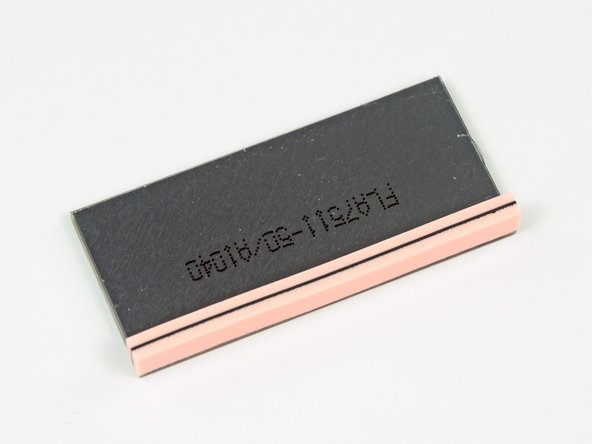

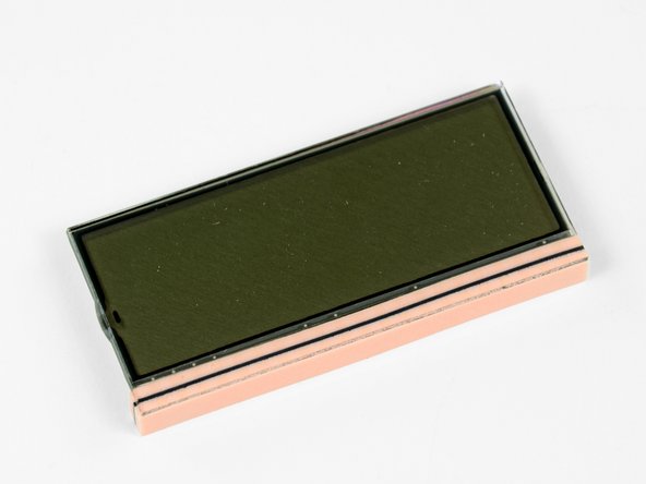

  11. Elster REX2 Smart Meter Teardown: crwdns2935265:011crwdnd2935265:01crwdnd2935265:03crwdne2935265:0 Elster REX2 Smart Meter Teardown: crwdns2935265:011crwdnd2935265:02crwdnd2935265:03crwdne2935265:0 Elster REX2 Smart Meter Teardown: crwdns2935265:011crwdnd2935265:03crwdnd2935265:03crwdne2935265:0
    • Lastly, we can remove the LCD.
    • As you can see, the monochrome LCD does not have any ribbon cables connecting it to the motherboard.
    • It seems to work via a method of conduction, where the bottom black strip comes into contact with pads on the motherboard, thus producing an image.
    • This method of LCD connection is very common, and the black and pink strip is called a "zebra connector."

The LCD connector is a commonly used "zebra strip". Multiple parallel (for redundancy)conductive paths in the strip carry the signal to each pad of the LCD glass substrate. These pads are are generally quite transparent. The connections to the display are self-aligning and the zebra strip provides cushioning for the LCD as well.
