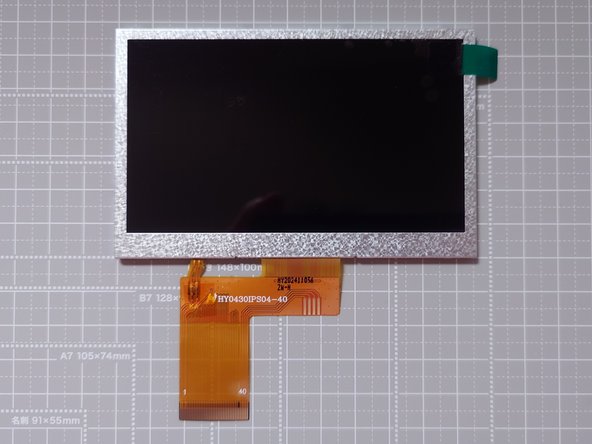

  1. Elgato Stream Deck MK.2 Screen Replacement, Buy a replacement screen: crwdns2935265:01crwdnd2935265:01crwdnd2935265:01crwdne2935265:0
    • It should look like the one on the picture. Pay attention to the shape of the ribbon cable.
    • must have a resolution of 480x272
    • must be 4.3 inch TFT
    • must have a 40-pin connector
    • should not have a touch capability
    • There are apparently various versions with different luminance. I bought a 1000 nits one and it looks just about right.

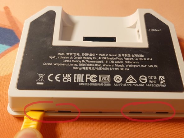

  2. Elgato Stream Deck MK.2 Screen Replacement, Remove faceplate: crwdns2935265:02crwdnd2935265:01crwdnd2935265:03crwdne2935265:0 Elgato Stream Deck MK.2 Screen Replacement, Remove faceplate: crwdns2935265:02crwdnd2935265:02crwdnd2935265:03crwdne2935265:0 Elgato Stream Deck MK.2 Screen Replacement, Remove faceplate: crwdns2935265:02crwdnd2935265:03crwdnd2935265:03crwdne2935265:0
    • Unplug the USB cable from the device and take the main unit out of the stand.
    • Pry gently at the 4 marked places to remove the faceplate.
