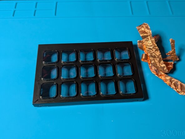

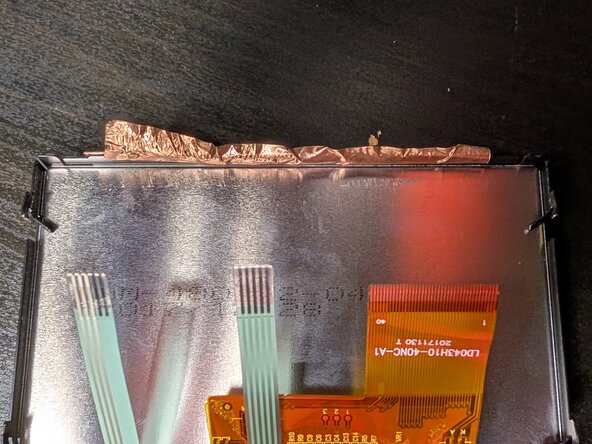

    • Gently pry the cover from around the buttons. It's a metal sheaf held on by clips at the top and bottom and something sticky, it's easiest to un-clip the top and then gently pry it upwards.
    • Underneath will be this metal case with copper tape near the top.

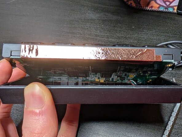

    • Use a prying tool to gently lift the metal container out of the shell. Directly underneath is a circuit board so try to pry on the wall rather than the bottom.
    • It will not lift-out too far because of the cables connected underneath, instead hinge it to about 70-90°.

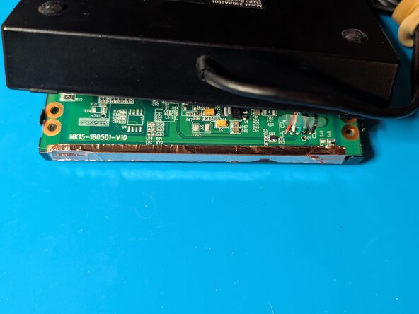

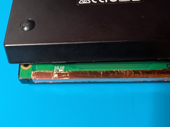

  3. Elgato Stream Deck MK.1 Screen Replacement, Remove the copper tape: crwdns2935265:03crwdnd2935265:01crwdnd2935265:02crwdne2935265:0 Elgato Stream Deck MK.1 Screen Replacement, Remove the copper tape: crwdns2935265:03crwdnd2935265:02crwdnd2935265:02crwdne2935265:0
    • Peel back the copper tape at the top and bottom of the circuit-board.

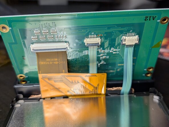

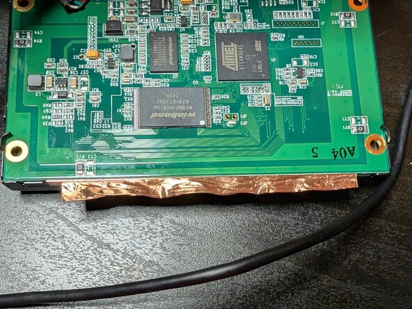

  4. Elgato Stream Deck MK.1 Screen Replacement, Free the circuit board: crwdns2935265:04crwdnd2935265:01crwdnd2935265:02crwdne2935265:0 Elgato Stream Deck MK.1 Screen Replacement, Free the circuit board: crwdns2935265:04crwdnd2935265:02crwdnd2935265:02crwdne2935265:0
    • Use a pair of pliers to bend these metal clips out of the way, so you can lift the circuit-board up out of it's chassis.
    • Use a prying tool to gently lift the circuit-board , there are ribbon cables connecting it to the screen underneath so don't lift too far.

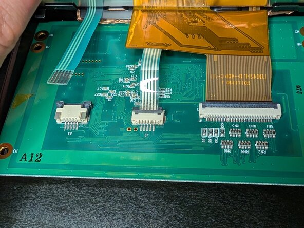

  5. Elgato Stream Deck MK.1 Screen Replacement, Seperate the circuit board: crwdns2935265:05crwdnd2935265:01crwdnd2935265:03crwdne2935265:0 Elgato Stream Deck MK.1 Screen Replacement, Seperate the circuit board: crwdns2935265:05crwdnd2935265:02crwdnd2935265:03crwdne2935265:0 Elgato Stream Deck MK.1 Screen Replacement, Seperate the circuit board: crwdns2935265:05crwdnd2935265:03crwdnd2935265:03crwdne2935265:0
    • Being mindful of all the connections, lift the circuit-board out entirely of the chassis so you can access the ribbon connectors.
    • Peel off the insulator tape above the connectors.
    • Disconnect each ribbon cable. The middle connector and the wide connector both have latches that lift/hinges upwards to release the cable. The remaining connector pulls forwards slightly.

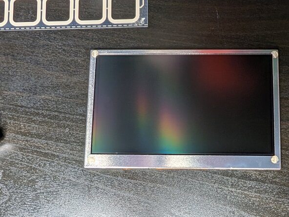

  6. Elgato Stream Deck MK.1 Screen Replacement, Extract the screen: crwdns2935265:06crwdnd2935265:01crwdnd2935265:03crwdne2935265:0 Elgato Stream Deck MK.1 Screen Replacement, Extract the screen: crwdns2935265:06crwdnd2935265:02crwdnd2935265:03crwdne2935265:0 Elgato Stream Deck MK.1 Screen Replacement, Extract the screen: crwdns2935265:06crwdnd2935265:03crwdnd2935265:03crwdne2935265:0
    • Admire your newly freed circuitry and then set it aside for later.
    • Peel back more copper tape connecting the screen to the chassis.
    • Use the pliers to again bend metal clips that are holding the screen in, then gently lift it out of the chassis.
    • There are six clips. One in each corner, plus two extras either side of the ribbon-cables.

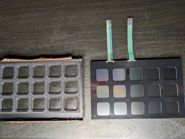

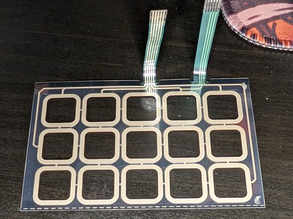

  7. Elgato Stream Deck MK.1 Screen Replacement, Seperate the button grid: crwdns2935265:07crwdnd2935265:01crwdnd2935265:03crwdne2935265:0 Elgato Stream Deck MK.1 Screen Replacement, Seperate the button grid: crwdns2935265:07crwdnd2935265:02crwdnd2935265:03crwdne2935265:0 Elgato Stream Deck MK.1 Screen Replacement, Seperate the button grid: crwdns2935265:07crwdnd2935265:03crwdnd2935265:03crwdne2935265:0
    • The button press-detecting grid thingy is a small thin plastic cover gently glued to the corners of the screen.
    • Gently peel it back from the screen to separate them. If there's any remaining sticky tape residue on the grid, peel it off.
    • Set the grid aside for later.

  9. Elgato Stream Deck MK.1 Screen Replacement, Prepare the button thing: crwdns2935265:09crwdnd2935265:01crwdnd2935265:03crwdne2935265:0 Elgato Stream Deck MK.1 Screen Replacement, Prepare the button thing: crwdns2935265:09crwdnd2935265:02crwdnd2935265:03crwdne2935265:0 Elgato Stream Deck MK.1 Screen Replacement, Prepare the button thing: crwdns2935265:09crwdnd2935265:03crwdnd2935265:03crwdne2935265:0
    • Add new double-sided sticky tape to the button chassis and insert the button-pressing-detecting grid thing. It fits flush to the top, there is a gap near the bottom where the ribbon cables are.
    • You'll know if it's upside-down because the buttons won't line up with the grid.

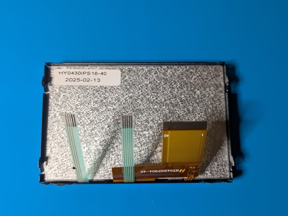

  10. Elgato Stream Deck MK.1 Screen Replacement, Insert the screen: crwdns2935265:010crwdnd2935265:01crwdnd2935265:02crwdne2935265:0 Elgato Stream Deck MK.1 Screen Replacement, Insert the screen: crwdns2935265:010crwdnd2935265:02crwdnd2935265:02crwdne2935265:0
    • Remember to peel the protective film from your new screen, be careful not to touch it after this or you'll get fingerprints on it.
    • Insert the screen on top of the button grid, the ribbon cables should all be on the same side, and the screen fits flush with the top. (The ribbon cables are the bottom).

  15. Elgato Stream Deck MK.1 Screen Replacement, Grounding the circuitboard: crwdns2935265:015crwdnd2935265:01crwdnd2935265:03crwdne2935265:0 Elgato Stream Deck MK.1 Screen Replacement, Grounding the circuitboard: crwdns2935265:015crwdnd2935265:02crwdnd2935265:03crwdne2935265:0 Elgato Stream Deck MK.1 Screen Replacement, Grounding the circuitboard: crwdns2935265:015crwdnd2935265:03crwdnd2935265:03crwdne2935265:0
    • On both sides re-apply the copper tape, ensure it covers half of the grounding components near the top.
    • If needed cut out a section and re-apply a small blanket.
