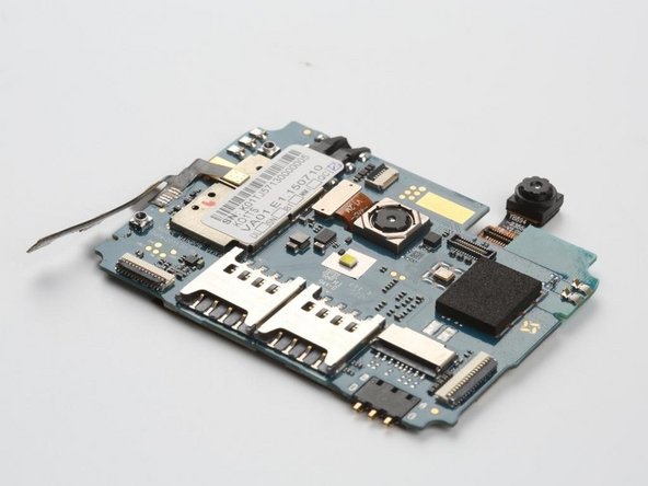

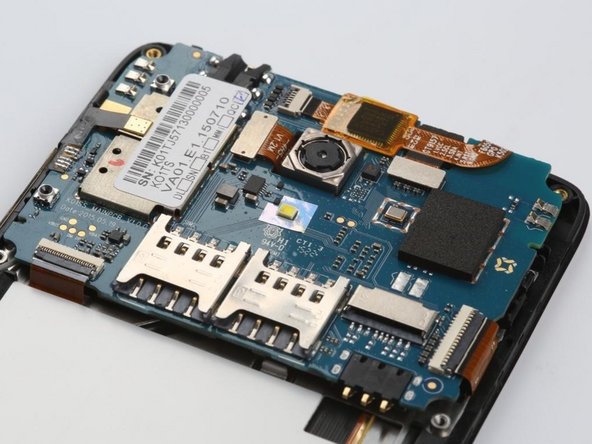

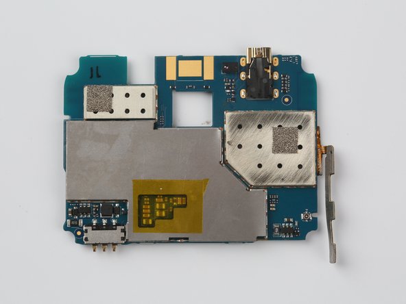

  3. Elephone P6000 pro Teardown, Mainboard: crwdns2935265:03crwdnd2935265:01crwdnd2935265:03crwdne2935265:0 Elephone P6000 pro Teardown, Mainboard: crwdns2935265:03crwdnd2935265:02crwdnd2935265:03crwdne2935265:0 Elephone P6000 pro Teardown, Mainboard: crwdns2935265:03crwdnd2935265:03crwdnd2935265:03crwdne2935265:0
    • After removing all the screws, we see the mother board which integrates all the chips and cameras. The parts are beautifully organized and we see the a bar code sticker glued on the welded metal cover.

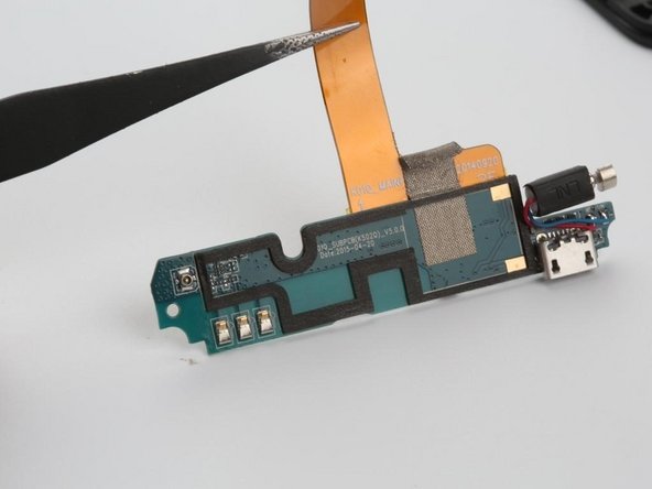

    • The secondary board integrates a USB port, a microphone and a vibration motor which is soldered on the board. It’s fastened by screws.

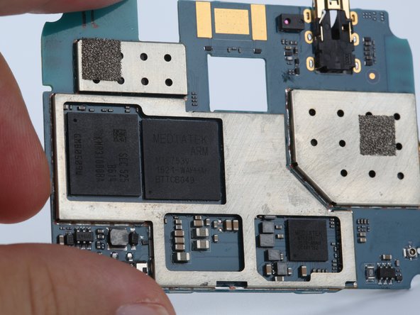

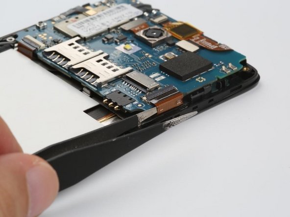

  4. Elephone P6000 pro Teardown, Mainboard detail: crwdns2935265:04crwdnd2935265:01crwdnd2935265:03crwdne2935265:0 Elephone P6000 pro Teardown, Mainboard detail: crwdns2935265:04crwdnd2935265:02crwdnd2935265:03crwdne2935265:0 Elephone P6000 pro Teardown, Mainboard detail: crwdns2935265:04crwdnd2935265:03crwdnd2935265:03crwdne2935265:0
    • On top you can see the Dual Micro SIM card (dual standby) and the the camera module.
    • On the bottom of the mainboard you can see the Octa Core MT6753 chip and the Mali T720 GPU.
  5. Elephone P6000 pro Teardown, Board removal: crwdns2935265:05crwdnd2935265:01crwdnd2935265:03crwdne2935265:0 Elephone P6000 pro Teardown, Board removal: crwdns2935265:05crwdnd2935265:02crwdnd2935265:03crwdne2935265:0 Elephone P6000 pro Teardown, Board removal: crwdns2935265:05crwdnd2935265:03crwdnd2935265:03crwdne2935265:0
    • Carefully remove the FPC (Flexible printed circuit) connection on the mother board, and peel off the protective sticker. There is a piece of FPC connects the secondary board.
    • To take the mother board off, remove the FPC connection with the display. It’s located on the right of the board.

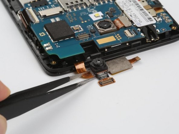

  6. Elephone P6000 pro Teardown, Mainboard removal: crwdns2935265:06crwdnd2935265:01crwdnd2935265:03crwdne2935265:0 Elephone P6000 pro Teardown, Mainboard removal: crwdns2935265:06crwdnd2935265:02crwdnd2935265:03crwdne2935265:0 Elephone P6000 pro Teardown, Mainboard removal: crwdns2935265:06crwdnd2935265:03crwdnd2935265:03crwdne2935265:0
    • Then gently prize up the joint of TP (Touch panel)
    • Disconnect the 2MP front camera.
    • The button volume and power button is glued tightly on the frame, so prize that up with great caution. Then we can take the mother board out.
  7. Elephone P6000 pro Teardown, Camera modules: crwdns2935265:07crwdnd2935265:01crwdnd2935265:01crwdne2935265:0
    • The picture shows the OmniVision 13MP primary camera and 2MP front camera.

Can you take a good photo of the top and bottom of the mainboard!
no way - crwdns2934203:0crwdne2934203:0
Please check the (newly added) Mainboard detail step.
