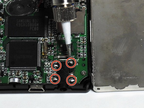

  3. Element GC-1020 Headphone Jack Replacement, Headphone Jack: crwdns2935265:03crwdnd2935265:01crwdnd2935265:02crwdne2935265:0 Element GC-1020 Headphone Jack Replacement, Headphone Jack: crwdns2935265:03crwdnd2935265:02crwdnd2935265:02crwdne2935265:0
    • Desolder the four points where it is soldered to the motherboard.
    • When completed pull the headphone jack off using tweezers and replace.
