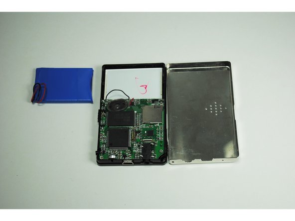

      • Unscrew the four screws (size: 3.175mm) on the left and right side of the Element Electronics GC-1020 device using the PH#0 screwdriver.
    2. Element GC-1020 Battery  Replacement: crwdns2935265:02crwdnd2935265:01crwdnd2935265:01crwdne2935265:0
      • Carefully pull the back of the device (the silver portion) apart from the rest of the device.
      • If you pull back too forcefully the power button would move out of place.
    1. Element GC-1020 Battery  Replacement, Battery: crwdns2935265:03crwdnd2935265:01crwdnd2935265:02crwdne2935265:0 Element GC-1020 Battery  Replacement, Battery: crwdns2935265:03crwdnd2935265:02crwdnd2935265:02crwdne2935265:0
      • Then remove the battery from the device through soldering the black and red wires connected to the motherboard.
      • This replacement will require a soldering station.
      • To find out more on soldering refer to the Soldering and Desolder page to help you through this process.
