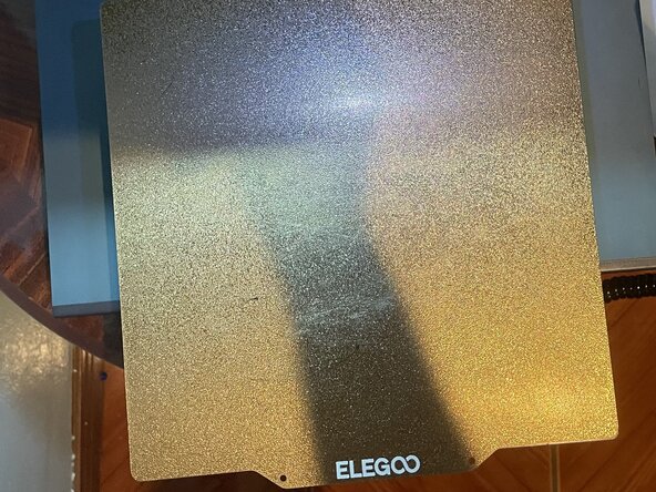

    • Remove any print waste or scraps of filament left from the bed. Clean thoroughly!

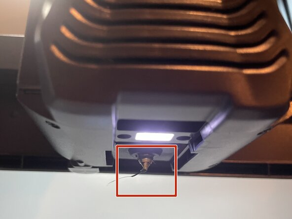

    • Check for a clogged nozzle.

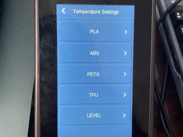

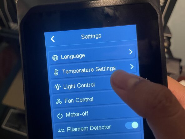

    • Go to "Settings."
    • Go to "Temperature Settings" and pick the filament you are going to use.

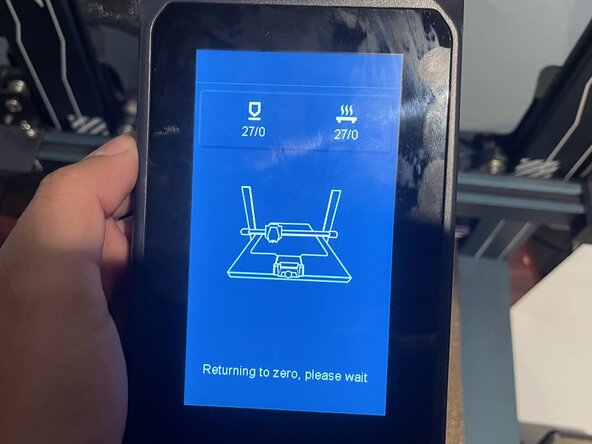

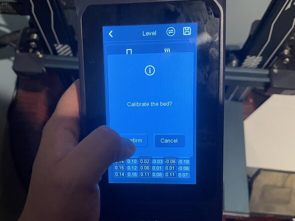

    • After picking your filament, you will be directed to a screen that asks you to either go to "Print," "Prepare", "Settings," or "Level."
    • Press "Level" to get started.
  5. Elegoo Neptune 4 3D Printer Manual Bed Leveling: crwdns2935265:05crwdnd2935265:01crwdnd2935265:03crwdne2935265:0 Elegoo Neptune 4 3D Printer Manual Bed Leveling: crwdns2935265:05crwdnd2935265:02crwdnd2935265:03crwdne2935265:0 Elegoo Neptune 4 3D Printer Manual Bed Leveling: crwdns2935265:05crwdnd2935265:03crwdnd2935265:03crwdne2935265:0

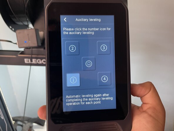

    • You will be guided to a new screen. For the purpose of this guide, focus only on the "Auxiliary" and "Automatic" buttons, located towards the center of the screen.
    • Press "Auxiliary" to manually adjust the bed.
  6. Elegoo Neptune 4 3D Printer Manual Bed Leveling: crwdns2935265:06crwdnd2935265:01crwdnd2935265:01crwdne2935265:0
    • Place a sheet of paper on top of the bed and nozzle.
  7. Elegoo Neptune 4 3D Printer Manual Bed Leveling: crwdns2935265:07crwdnd2935265:01crwdnd2935265:02crwdne2935265:0 Elegoo Neptune 4 3D Printer Manual Bed Leveling: crwdns2935265:07crwdnd2935265:02crwdnd2935265:02crwdne2935265:0
    • Turn the wheels at each corner and in the middle so that a piece of paper can slide between the nozzle and the bed with slight resistance.
    • Do this at least twice to make sure that the paper can move between the bed and nozzle with little resistance.
    • On the printer's screen, tap each of the four corner points and home one at a time.
    • The nozzle will move to each selected corner.
    • At each corner, adjust the bed to set the correct distance between the nozzle and the bed.
  8. Elegoo Neptune 4 3D Printer Manual Bed Leveling: crwdns2935265:08crwdnd2935265:01crwdnd2935265:03crwdne2935265:0 Elegoo Neptune 4 3D Printer Manual Bed Leveling: crwdns2935265:08crwdnd2935265:02crwdnd2935265:03crwdne2935265:0 Elegoo Neptune 4 3D Printer Manual Bed Leveling: crwdns2935265:08crwdnd2935265:03crwdnd2935265:03crwdne2935265:0

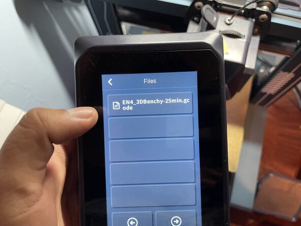

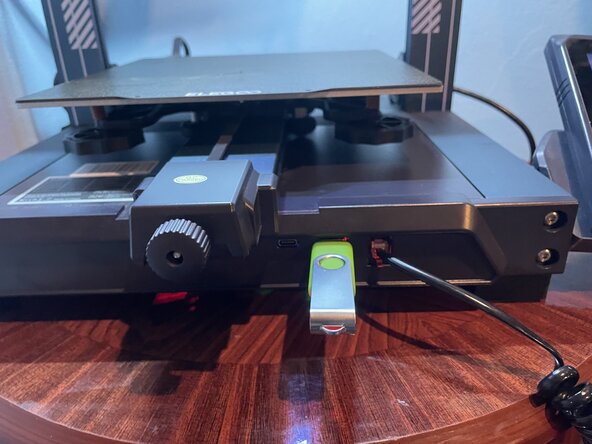

    • To check that your bed leveling is correct, begin a new print.

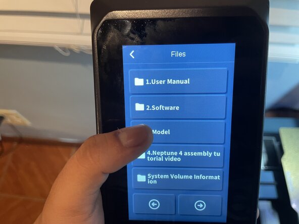

    • Insert the USB that contains your G-code file into the 3D printer.
    • The USB that you receive with the purchase of the Neptune 4 already contains files of models that you can print!
  9. Elegoo Neptune 4 3D Printer Manual Bed Leveling: crwdns2935265:09crwdnd2935265:01crwdnd2935265:03crwdne2935265:0 Elegoo Neptune 4 3D Printer Manual Bed Leveling: crwdns2935265:09crwdnd2935265:02crwdnd2935265:03crwdne2935265:0 Elegoo Neptune 4 3D Printer Manual Bed Leveling: crwdns2935265:09crwdnd2935265:03crwdnd2935265:03crwdne2935265:0
    • Pick your G-code file that contains your model to start the print.

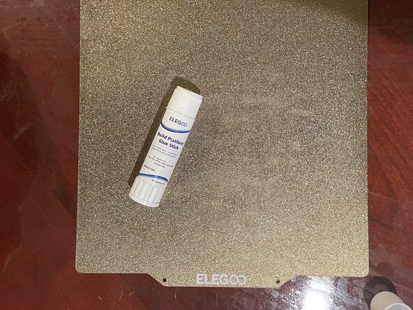

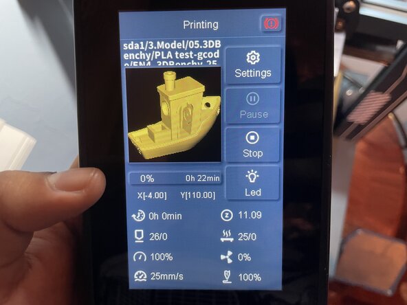

    • Apply a thin layer of glue to the build plate to improve print adhesion and start a print.
  10. Elegoo Neptune 4 3D Printer Manual Bed Leveling: crwdns2935265:010crwdnd2935265:01crwdnd2935265:03crwdne2935265:0 Elegoo Neptune 4 3D Printer Manual Bed Leveling: crwdns2935265:010crwdnd2935265:02crwdnd2935265:03crwdne2935265:0 Elegoo Neptune 4 3D Printer Manual Bed Leveling: crwdns2935265:010crwdnd2935265:03crwdnd2935265:03crwdne2935265:0
    • Press "Confirm" to start the print.

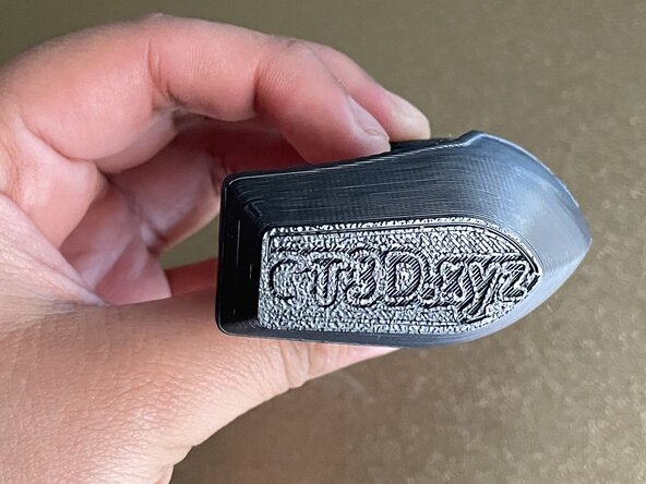

    • Make sure to pay attention at the beginning of your print. If the bed is not leveled correctly, then your print will get messed up. To avoid wasting filament, stop the print and try again.
    • For example, I printed a Benchy boat, and the text on the bottom is clearly visible and correct, which indicates that the bed was properly leveled.
    • If your print has clear text, congratulations! You have successfully leveled your Neptune 4 3D printer!
